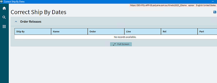

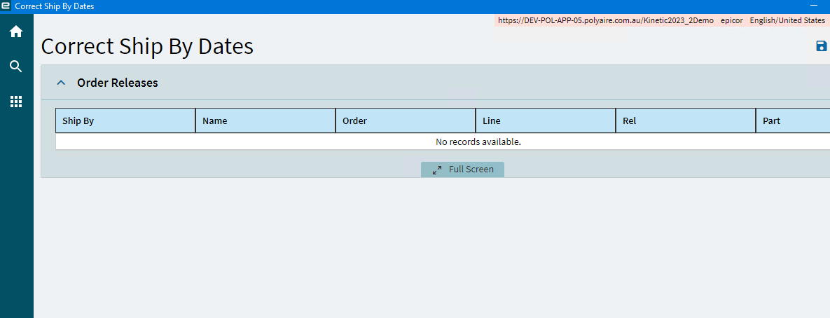

Hello,
Does anyone know about the Correct Ship By Dates dashboard, appears to have been introduced around v 2023.
There appears to be no documentation about it. Logged a ticket, but wanting to know if anyone is using it, and I am assuming along with the Shipping Calendar???

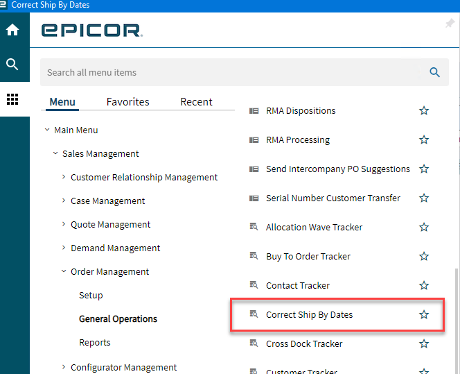

Never used it before but did a little quick digging this morning.
It’s an updateable dashboard that shows you any sales order releases with an invalid ship by date.
Grid comes from updateable BAQ: zCorrectShipByDates
To set up:
  • Go to Production Calendar.
  • Add a new calendar. (you may choose to use an existing calendar)
  • Define which days in the year where you cannot ship. E.g. all Saturdays/Sundays.
  • Go Site Configuration.
  • Choose your site.
  • Click on Shipping Receiving
  • Select your calendar.
Now when you put in a Order release with a ship by date on a Saturday, that order line/rel will appear on the Correct Ship By Dates Dashboard. You can correct the date from the dashboard.
