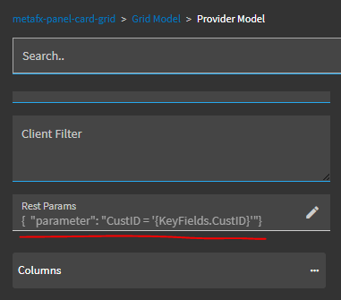

Does anyone know the correct format (if there is one) for sending in a parameter value to a BAQ from a panel card grid? I know I can remove all parameters and just filter in the BAQ Options to get what I’m trying to get, but I’d like to know if this is even an option.
I’ve tried a few different formats but nothing I’ve entered seems to go through and the parameter slideout always pops up. Does anyone know if there’s a correct way to do this? The goal is to have the grid run the query when it’s opened and then display the rows in the grid.
Put the where clause under BAQ options. There are syntax examples floating around here, its something like fieldname = ‘{criteria}’
