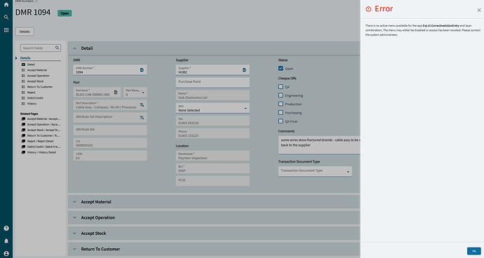

Got another issue with accessing Corrective Actions from the DMR ellipsis, i am getting the following error
I can access CA fine from the Menu and the custom layer works fine, what have i done wrong, it worked fine before we upgraded.
If i remove the custom layer from CA it opens fine from DMR…

Two options:
1:Custom Layer on DMR, change the app-open to launch your customized menu item, put the custom layer for DMR on the menu. (if you want DMR to use your custom Corrective Actions layer, you will need to go this route)
2:Add the Base menu into processes (so that it doesnt show up on the main menu) - then DMR will be able to load the base.

I believe you actually want to remove the layer and repoint the app to the menu id, not that full string.
So put the menu id in the View section?
If what you currently have does not work, yes. I have that in my list of things I have to change during our upgrade to 2025.2, the way you have it works prior to 2025.2 but after that I have had to remove the layer reference from the launcher and point to a specific menu id that contains the layer.

I would say your start item probably needs to be an Event>Override and then select the original Event you want to override (the one you copied to create this).
Ah i see, something like this -
I believe so, yes, this has been my experience with 2025.2 (the override has always been that way).
This works, i find it rather backwards that we are having to do this whereas before, prior to 2025, it wasnt an issue.
