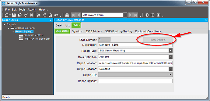

When we upgraded from 10.0.700 to 10.1.600, many of our RDD got broken. I was told the Sync Dataset button on the Report Style Maintenance screen would fix it. That button did not always work for our issues, but it is worth a try.
That button fixed all of my custom report issues after upgrading, but this particular one was with an out of the box report. I made a copy of this particular report style (since you can’t sync the standard) and tried synching and it didn’t work.

*I uploaded the RDL files to the proper report server folder as called out by the Report Style
*I synched the Dataset from the Report Style
*I then had to reupload the RDL files before it worked
It doesn’t make a lot of sense, unless synching the Dataset corrupted the newly uploaded RDL files–I’m not sure how that whole process works, but after doing the steps above, it’s working.
