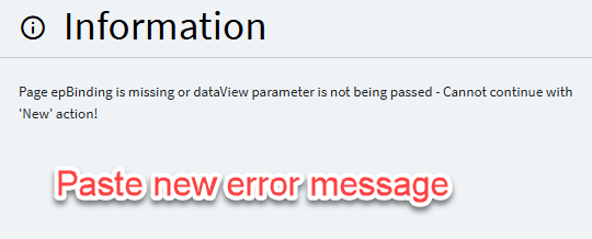

When i try to do the paste new, i get the error message below.

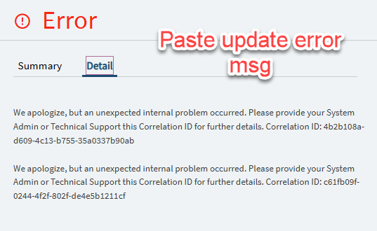

When i try the paste update, i get the following error message:
You will use paste new, not update
Are you only copying the rows from excel and does your column order match?
Do you have any customization layers on this page?
Reach out to support if you continue to get this
No customization. I initially enter a part number and load the cost. Then i go into list view and copy all including labels to an excel sheet to use as my template. I then load the template with the rest of the parts, cost, reason code and then try to do the paste new and/or update and there i get stopped.

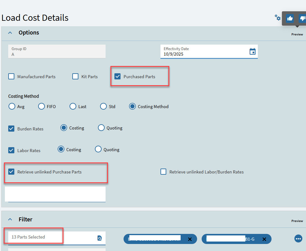

Is it possible to update only Purchase parts in the Costing Workbench? I tried that before but did not load the purchase parts. Usually i load mfg. parts in the costing workbench which then breaksdown the BOM into mfg. components and purchase parts.
But if i wanted to only update the purchase parts, i am not able to upload it in the costing workbench.
When you load I think you choose the part type- purchased or manufactured.
Also check out what happens when you say “retrieved unlinked purchased parts” which is every purchased part not on a BOM and all the rest as well I think.
But yeah I’m pretty sure you can also see in those columns the last cost and then you can paste insert there… but maybe back to the same issue idk.

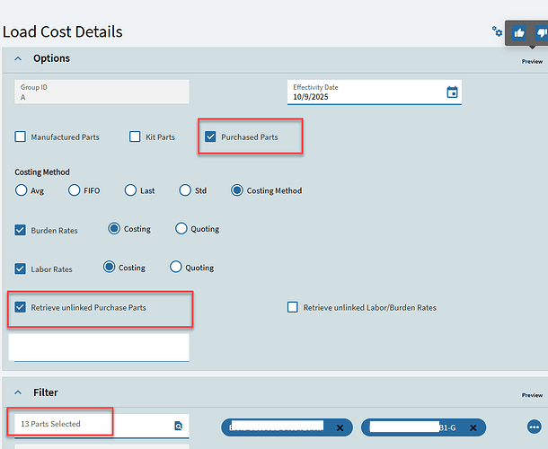

Yeah, i tried that with the “Retrieve unlinked purchased parts” which did bring in the parts but it brought in the entire universe of purchase part. I had the load cost details filtered for only 13 parts that i wanted to update the cost for but Costing workbench brought in over 14,000 purchase parts.
Classic. Wonder if they’ll ever fix that. It’s been that way forever and makes no sense. What’s the filter for if it doesn’t work. I need to report it or something.
I think i am on to something. i tried to order the columns in the Cost Adjustment app in different ways and i did not get an error when i arranged the columns in Part, Std Mtl Cost, Reason Code, Reference.
So, that’s an improvement from the errors. But i can’t see what it’s doing until it’s done. IN the old Epicor, each part would be posted and visible as it pastes in. Now the screen is blank until everything is pasted. If an error occured, then message will pop up to abort or continue.

Thanks, i am glad i am not the only one. I was able to get the Cost Adjustment to load multiple parts using the list view. But the order or the columns has to be re-arranged from the default. But i dont see the parts being loaded until there is an error, which i don’t like.
