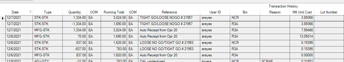

Hi,
Can someone explain to me why the cost of this part is all over the place? Thanks
It’s because when the auto reciept happened, you had no labor on the job, and no materials were issued yet, so the first receipt is at $0. Then things got issued and labor entries finished, so your second auto-receipt carried all of that cost. And on the 3rd auto receipt, it’s closer the the actual average. If you don’t do everything in exactly the correct order, you’re going to get some weird numbers.
That makes sense. Thanks Brandon
