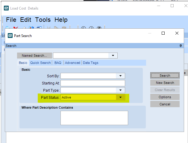

Furthermore, I thought we could force the Group to NOT include inactive parts by using the Filter Part Search during Load Cost Details to only include Active… but that option is greyed out and it’s set to Active… so at that point it seems like something is trying to only allow you to search and include Active parts… but if you don’t specify a search filter it then includes Inactive? what gives?
