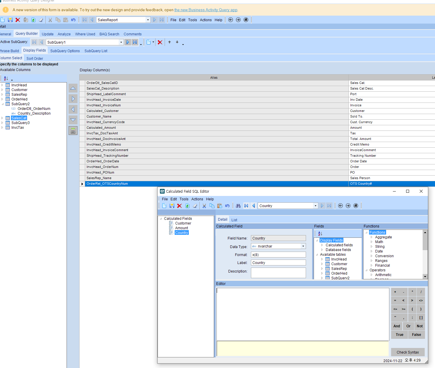

I want to create a BAQ that includes the country name of the order’s destination. The ultimate goal is a sales report based on the AR invoice.
However, I ran into one difficulty. I need the destination country name. I found out that OrderRel_OTSCounrtyNum had the field values I wanted. But that field is just a number, and I need a Description.
I want to create a SQL that will fetch this CountryNum into Description.
Please help me. Thank you very much.

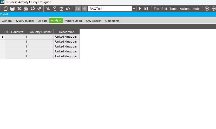

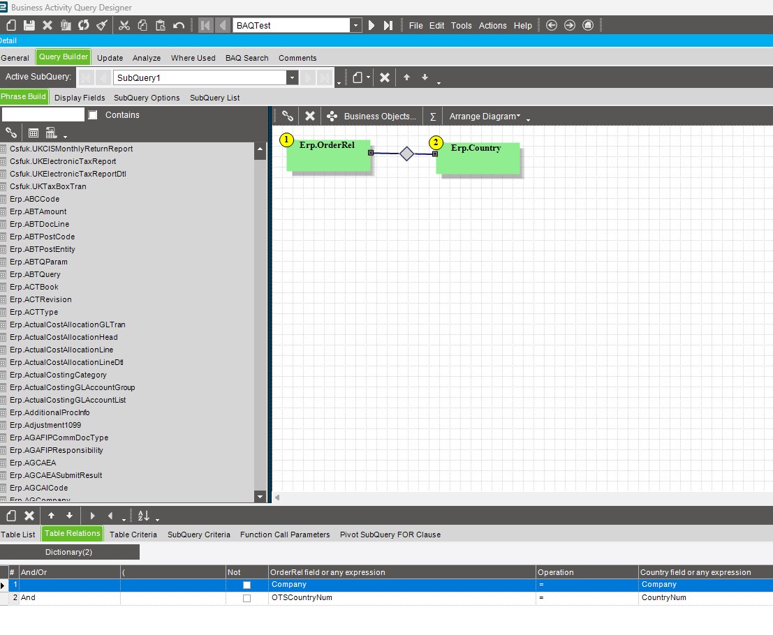

Hi,

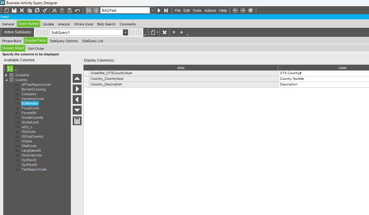

As Gill said you can link the country table for the country name, I don’t think you need to use a calculated field as per your screenshot.
  1. Join the Country table to the OrderRel table on Company = Company and OTSCountryNum = CountryNum
  1. Select the ‘Description’ field from the Country table
  1. Check results, this should give you country name:
One other thing might be worth checking is that I think the OrderRel.OTSCountryNum field will only be populated if you are using One Time Ship-To addresses on the order. If you are using saved Ship To addresses I think you will need to look at another table for the address details.

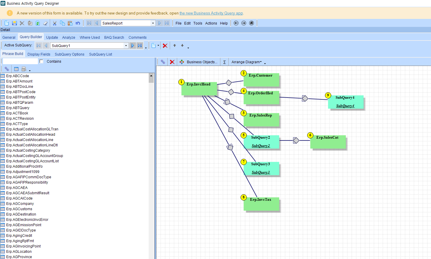

Sorry, I didn’t tell you about my Phrase Build situation earlier.
I want to use InvcHead to represent one line per Invoice. Total amount and some additional information related to Total, etc…
When I connect OrderDtl, the lines increase as many as the number of Dtl.
So I’m looking for another way.

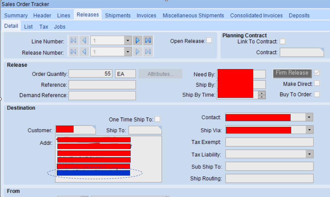

Actually, the field I want is the blue one in the screenshot, in Order Releases. But, I couldn’t check the DB Field in the field help.
There is also the field OrderRel.OTSCountryNum but it only seems to be populated if you have entered a different OTS on the release compared with the OTS input into the order header.

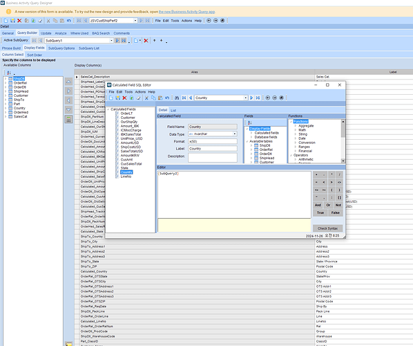

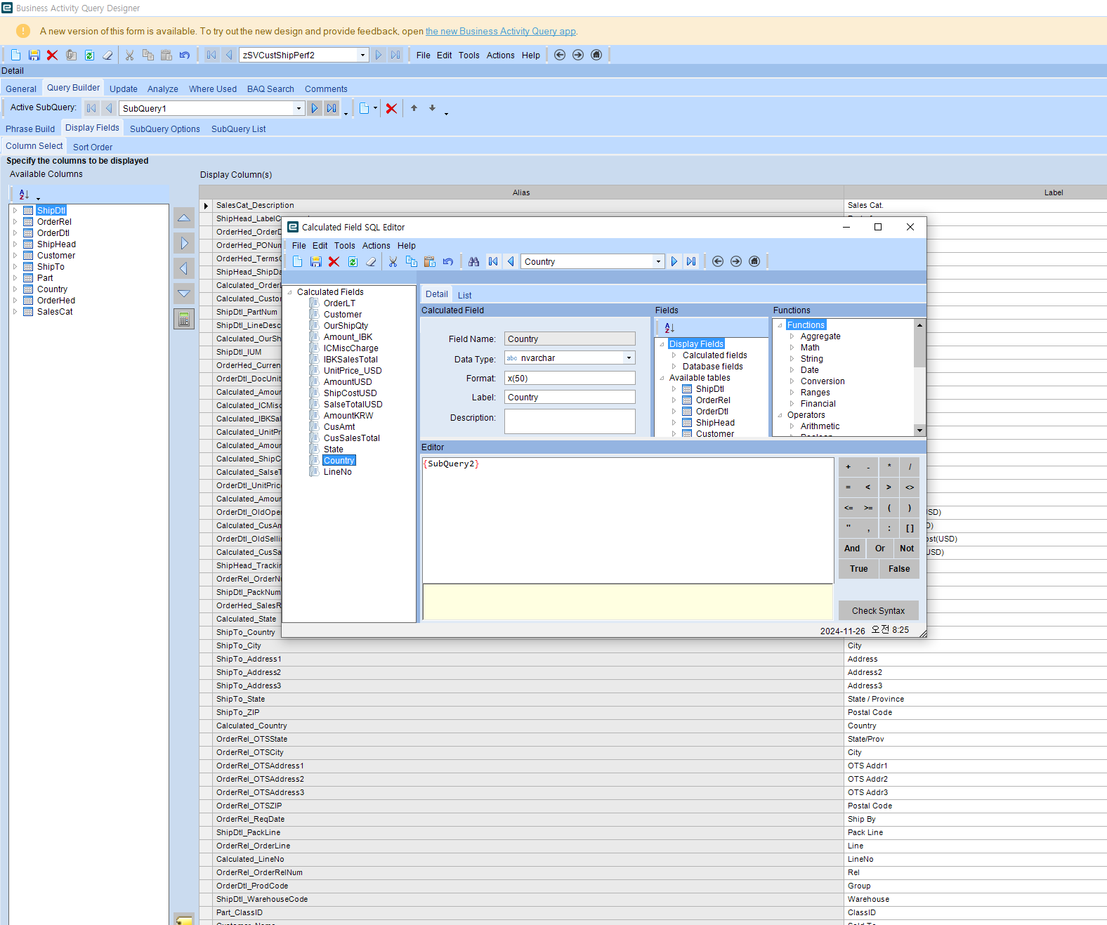

In fact, my now retired colleague implemented exactly the country name I wanted.
The BAQ below is his. I don’t have contact with him, so I can’t ask him.
I hope this helps.

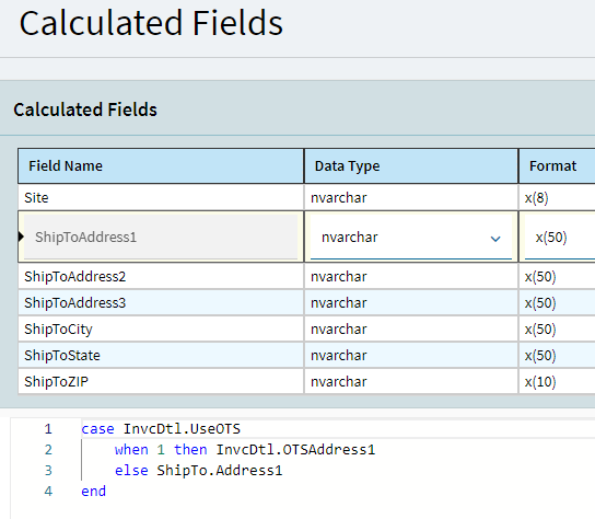

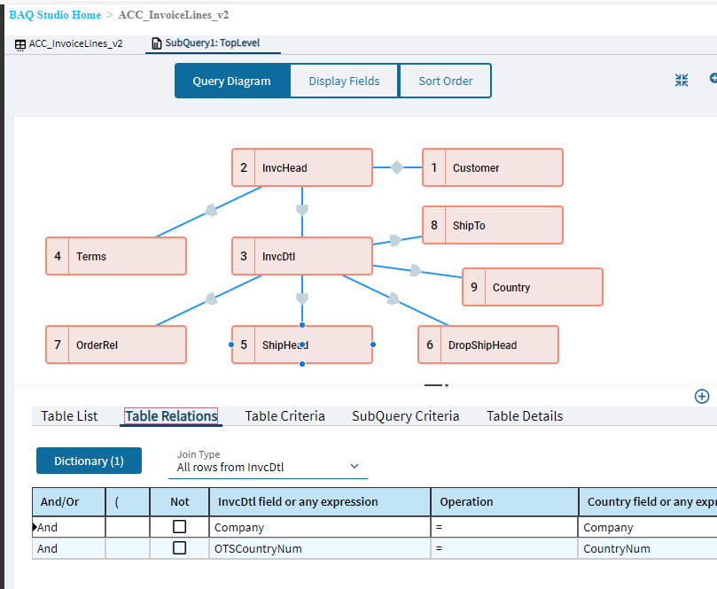

Here’s the BAQ I made:

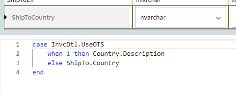

Then 6 calculated fields like this:
And the 7th - country - being the oddball:
This is what everyone has been saying basically, but to put it all together:
  1. If the order has a “one-time ship-to,” then the address info is on the OrderHed table
  2. If the order has a ship-to selected, you need the ShipTo table for the data
  3. If you have no ship-to selected and it is not a “one-time ship-to” … you actually do have a ship-to - its ID is "" [empty string].
    a. (You can ignore this advice; it’s covered by #2.)
  4. City is free text in 1 and 2
  5. So is State/Province, ZIP, etc.
  6. But Country is text in the ShipTo table and an integer in the OrderHed table.
    a. Thus you need to join in the Country table for the sake of one-time ship-to.
