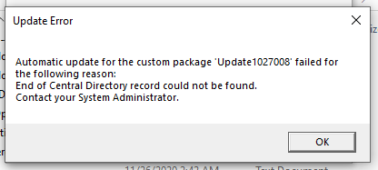

About half of our PC’s can’t update epicor. Tried reinstalling it from scratch, making sure windows is fully updated, etc…
Any idea what to try? Support hasn’t been any help so far…
We got a work around. Copying the epicor folder from computers that are working to the ones that were not working is getting us going.
Better solution will be remove \skip from Epicor shortcut.
I didn’t have \skip on it. I completely uninstalled and re-installed epicor and the issue persisted.
