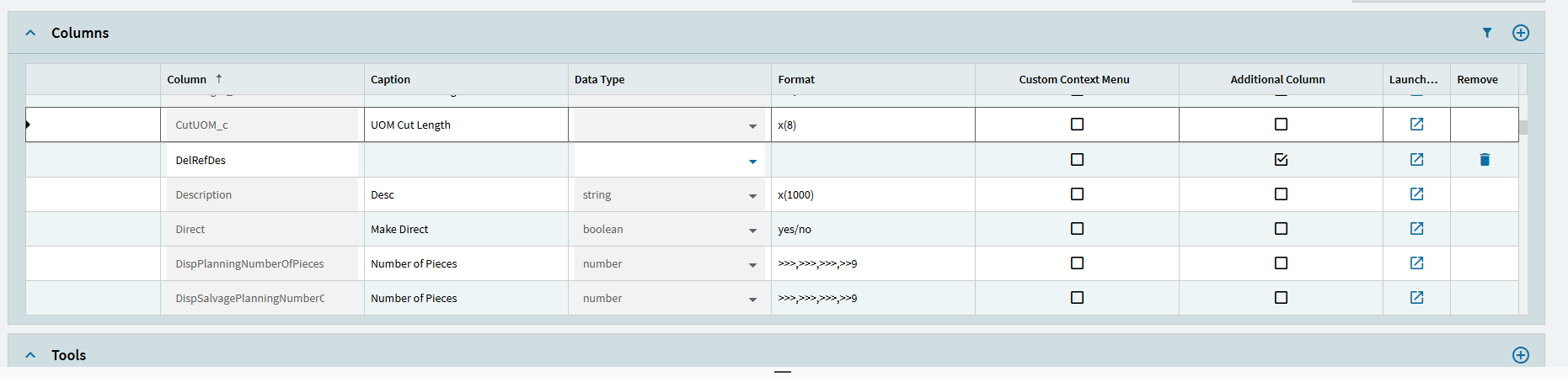

I’m making the quote in Kinetic Quote Entry with a configurator linked to my CPQ configurator, and a part to link the BOM. The only thing odd that I’ve been able to find is the UD column fields have no data type in the dataview QuoteMtl in application studio on Quote entry, so not sure if this is a bug somewhere?
