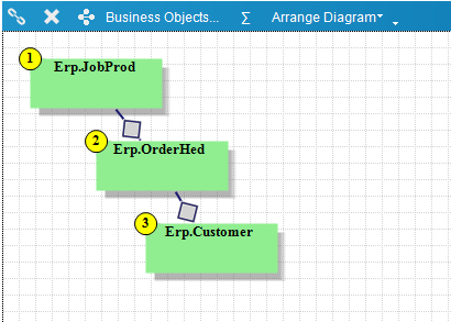

What I would do personally, is write a BAQ to learn the linkage. Create a parameter that inputs a job and then returns the field in the customer table that indicates this should be a RUSH order. Something like this:
Play around with it. Make sure it returns only one record for each job. I’m not sure if you would ever use one job with multiple Make-To-Order records, but if you do, then you’ll have some tweaking to do.
If you run Custom Code, convert the BAQ SQL to a LINQ statement. Not tested, but probably something like this:
from Erp.JobProd as JobProd
inner join Erp.OrderHed as OrderHed on
	JobProd.Company = OrderHed.Company
	and JobProd.OrderNum = OrderHed.OrderNum
inner join Erp.Customer as Customer on
	OrderHed.Company = Customer.Company
	and OrderHed.BTCustNum = Customer.CustNum
I used LinqPad to convert the BAQs SQL to LINQ.
I have tired of trying to link two tables together. :rofl: There are others on the list who are far better than I am and do LINQ all the time.
Take the result and set your JobHead.SchedCode accordingly.
If you use an In-Transaction Directive, then you must use a Custom Code widget. If you use a Method Directive (Preprocess on the Update method for example) then you can either call the BAQ directly using the Invoke BO Method or you can also use the custom code widget.
