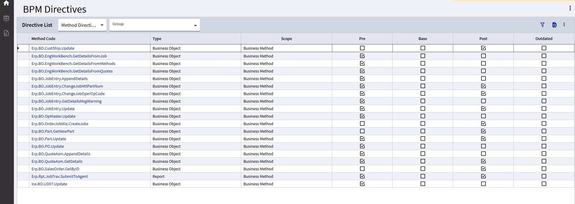

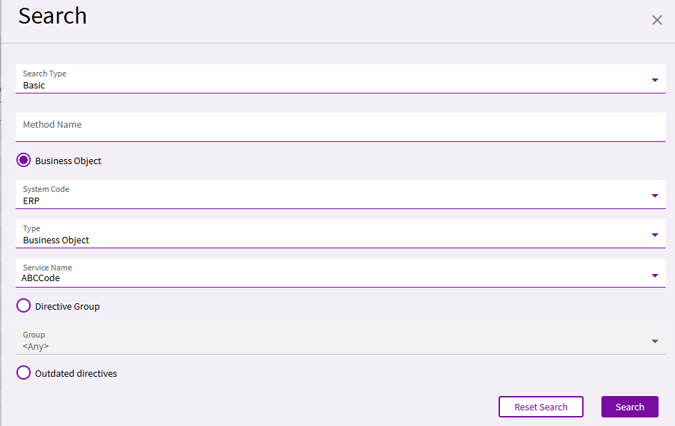

If the BO/method you’re looking to write a BPM for does not already appear in the list of active BPMs… you first have to click the SEARCH icon.
This is where you can search for the target BO and method.
Once a BO/Method is selected in the search, the other icons are enabled.

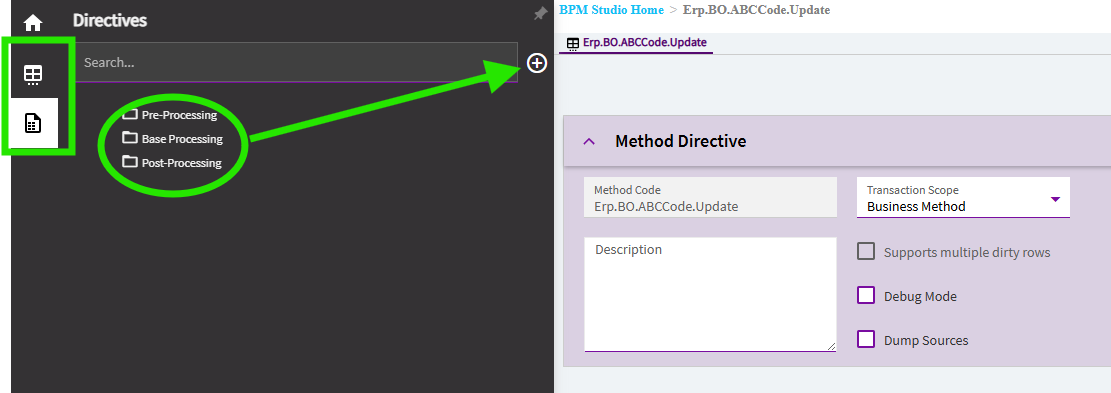

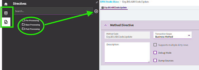

Click Pre, Base, or Post in the list and then click the new icon to start a new BPM.
