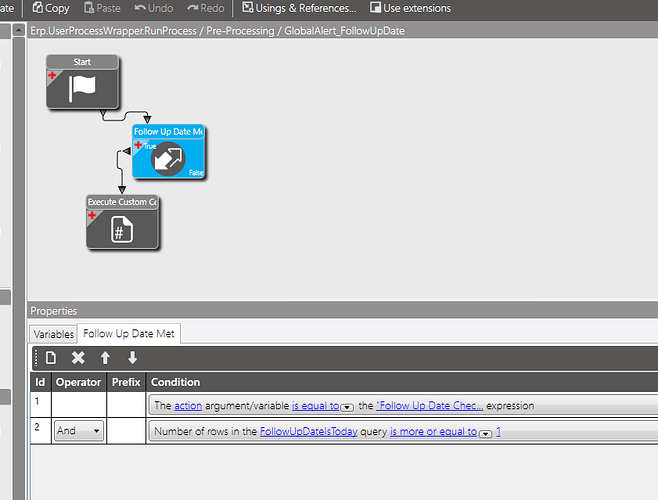

I did something similar, perhaps slightly less complex on the requirements, but utilizing User Process Wrapper to schedule and execute the custom task on a schedule. You’ll probably be able to do it via a Function if you’re on a high enough version.
The conditions you described can be encapsulated in your BAQ, plus any other ones necessary. If that is met, you can proceed with either generating an email or creating a task, etc.

You could probably do it all with widgets if you want.
Then, it’s a matter of scheduling the process or function in Epicor to run daily (or whatever the requirement is).

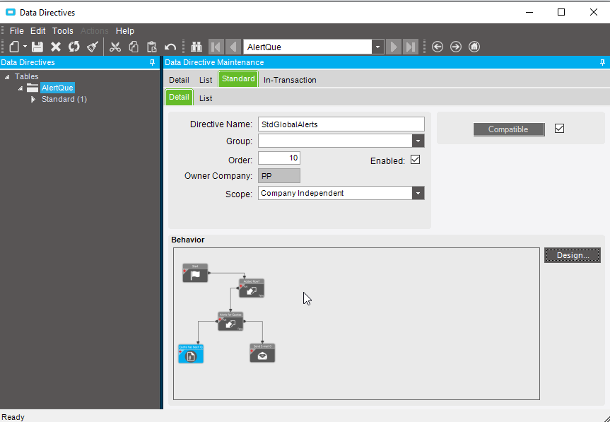

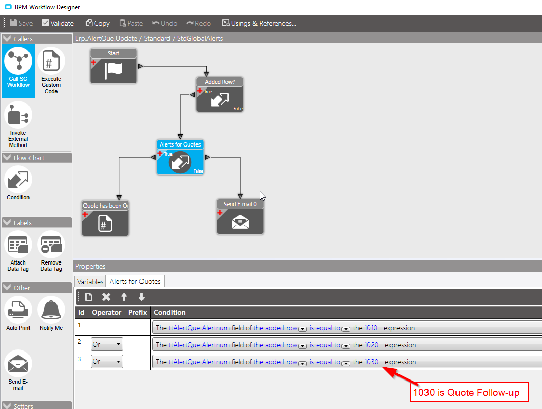

There is a standard follow-up alert functionality built into data directive AlertQue:
I have custom code composing slightly different emails when quotes are first quoted (1010), when the quote expires(1020), and when the quote reaches its follow up date as defined in the quote header tab (1030). But, you could do anything you want once you see the AlertNum = 1030 in the directive.

There something slightly quirky about when the follow-up alert trigger runs on any given day. It doesn’t run until one person opens the Quote Entry screen. So, over the weekend for example, the follow-up messages don’t come out until Monday morning.
That’s exactly why I rolled my own :wink:

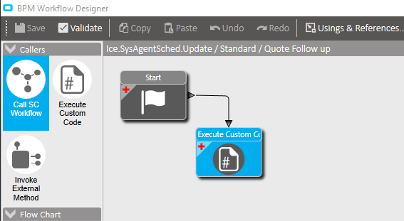

Don’t know if this helps, I run this on a Sys Agent Schedule that fires off each morning, you could add more conditions into it and add a foreach on the Db.QuoteDtl table to check your product groups
Its on a Standard Data Directive
I have another BPM that sets the followup date, but you can also set that in the company configuration
bool tvSYS = ttSysAgentSched.Any(s => s.Updated() && ttSysAgentSched.Any(s1 => s1.Unchanged() && s1.SysRowID == s.SysRowID && s1.LastRunOn != s.LastRunOn && s.AgentSchedNum == 177181));
if (tvSYS == true)
var quotes = Db.QuoteHed.Where(q => q.Company == Session.CompanyID && q.FollowUpDate == DateTime.Today && q.QuoteClosed == false /* add more conditions here */ ).Select(x => new {x.QuoteNum, x.BTCustNum, x.ChangedBy, x.Company}).ToList();
