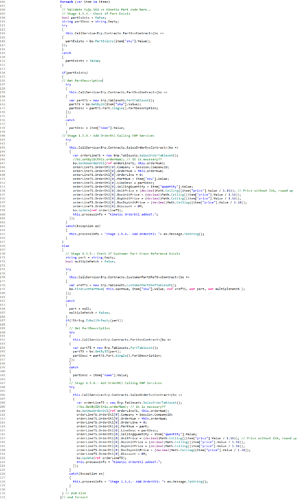

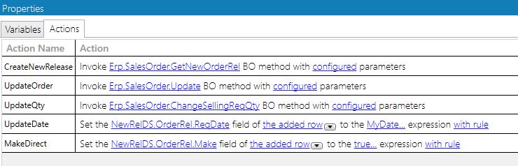

My BAQ lists a few handy fields for me including the customer’s requested quantity and date for the order, as well as some internal fields like OrderNum, OrderLine andOrderRelNum.
To pull data from the BAQ into my BPM I use this custom code to assign current row values to internal variables. There is a lot of if/then work to make sure I am updating with the correct values.
var ttResults_xRow = (from ttResults_Row in ttResults where ttResults_Row.Calculated_NewRelease == true select ttResults_Row).FirstOrDefault();
if (ttResults_xRow != null) // make sure there are more BAQ rows to process
if (myrow <= totalrows) // make sure there are more BAQ rows to process
if (IsNewLine == true)
// we just added a new line. check to see if the next rel to add is for the same order and line.
// (have to match on xrev, because the BAQ doesnt know what line number the new line is.)
// if it is then, add the rel to the existing order/line.
if (MyOrder == ttResults_xRow.OrderHed2_OrderNum && MyXRev == ttResults_xRow.Calculated_MyXRev)
//MyLine is already set from SetMyLine custom code widget
MyQty = ttResults_xRow.Calculated_CustFinalQty;
MyDate = ttResults_xRow.UD03_Date01;
MyPart = ttResults_xRow.UD03_Key4;
MyDescription = ttResults_xRow.UD03_ShortChar02;
MyPrice = ttResults_xRow.UD03_Number02;
MyRev = ttResults_xRow.OrderDtl5_RevisionNum;
MyXRev = ttResults_xRow.Calculated_MyXRev;
MyShipTo = ttResults_xRow.UD03_ShortChar01;
ttResults_xRow.Calculated_NewRelease = false;
IsNewLine = false;
ClosedOrder = false;
ClosedLine = false;
// if it is not then, add the rel to the order/line suggested by the BAQ.
else
MyOrder = ttResults_xRow.OrderHed2_OrderNum;
if (String.IsNullOrEmpty(Convert.ToString(ttResults_xRow.OrderDtl1_OrderLine)))
MyLine = 0;
else
MyLine = ttResults_xRow.OrderDtl1_OrderLine;
ClosedOrder = ttResults_xRow.OrderHed2_OpenOrder;
ClosedLine = ttResults_xRow.OrderDtl1_OpenLine;
IsNewLine = false;
else
//not a new line, if xrevs match, use order number from BAQ and use existing line number, otherwise create new line from baq line
ClosedLine = false;
else
MyLine = 0;
else
After this, I use SalesOrder BO methods to open/close orders/lines, add and update releases.
In these methods I always reference my internal variable for things like order and line number.
I hope this helps a little. I’d be happy to answer any other questions that I can!

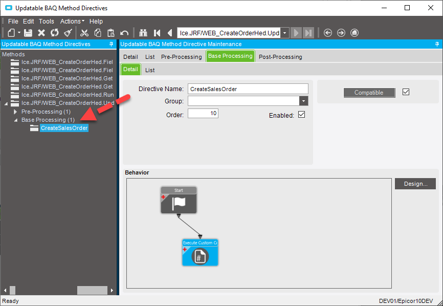

using the advanced BPM updated, pre-processing on Update. It just writes a msg to the log. I did also enable it, despite the screenshot.
When I update the row with placing a value in my calulated field, and click Update, I get this exception

I’ve searched the forum a bit and this seems to be an oddity…any ideas?
Make sure you click the “Enable” checkbox in your method directives.
Sometimes I would get this error if I didn’t have a blank method in the Update base directive. Just add a new base method to the update and insert a blank custom code element (with just a comment), then enable this empty method on update. It’s worth a shot!
Oooo, that worked. That’s dirty
Once you’ve opted for Advanced BPM you might as well put everything in Update Base anyway rather than pre-processing. There is no base otherwise, as you’ve found.

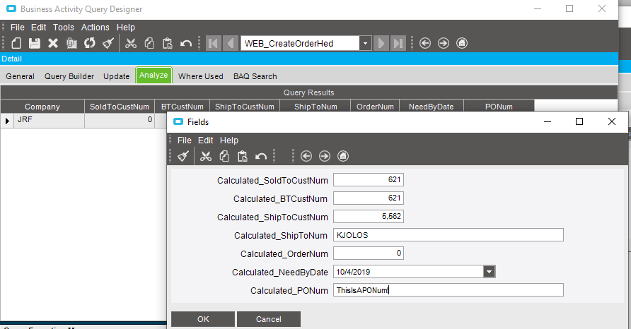

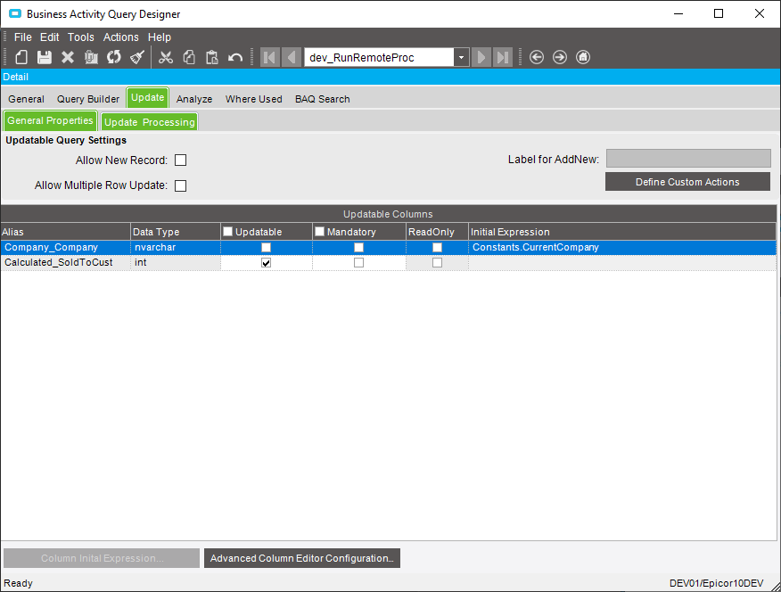

Got it working nicely with uBAQ and Advanced Update Processing.
Basically, I set up my uBAQ on Company like Jose suggested to return 1 row. I then created my “input” fields as calculated fields and gave them default values
I made the uBAQ updatable and set the calculated fields to updatable.

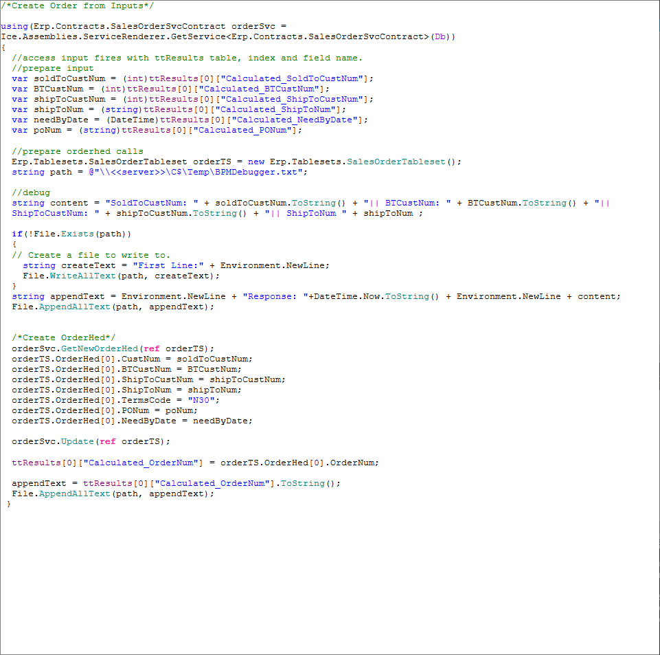

I then created a base processing directive (thanks @dhewi and @NateS) with my custom code
I added a reference to Erp.Contracts.BO.SalesOrder using the “Using and References” functionality.
Then, I wrote out my code with a little debugger in it too (add using System.IO if you want to use that)
To invoke, run a GetList in the BAQ editor and then double click the row to update the fields.
Note: my web app is calling other BAQs to get the valid combo of CustNum, BTCustNum, ShipToCustNum, etc. so that it’s not junk data. Here is where the API would be setting these fields, which I won’t go into right now.
After the fields are set, I click Update to invoke the Update method of this BAQ, which calls the custom code.
This is blazing fast and allows me to add any business specific logic server side, while also insulating the web app from changes to Epicor, such as the complex datasets that are associated with the direct BO calls and the API version, to some extent.

If anyone might be interested, I’ve attached a UBAQ export based on your notes above.
UBAQ-SalesOrder.baq (28.3 KB)
Note that I substituted the path as @“C:\TEMP\BPMDebugger.txt”
and had to verify the TermsCode “N30” existed in E10.
Thanks for your original example and for comments by others.

The ICE Tools User Guide will only get a person so far.
Nice sample code, can you share how to add OrderDtls too (after /Create OrderHed/) please!

This is my code to add lines, based in your sample code:
Thanks!
