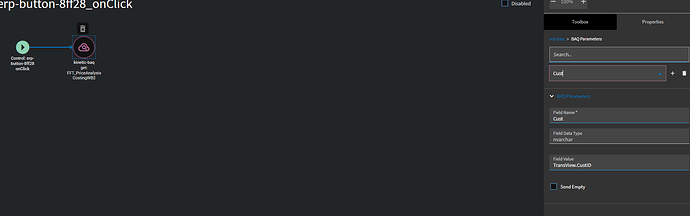

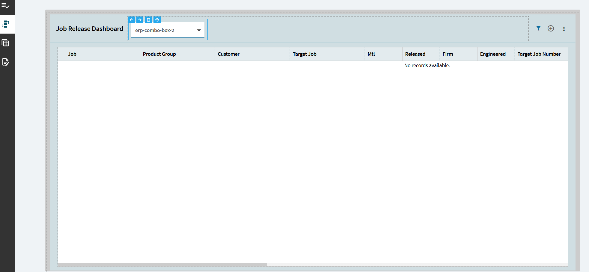

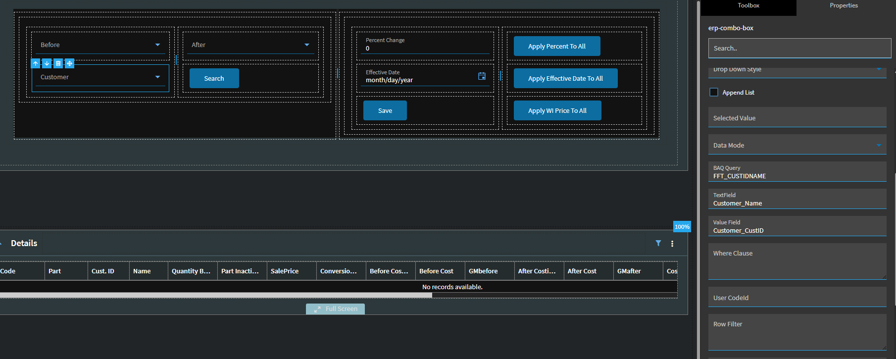

I have used dropdowns to filter/limite the dataset. In this example, I populated the dropdown with a BAQ:

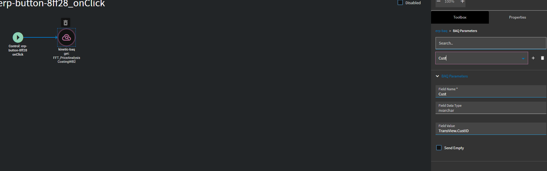

And the value is passed as a parameter in the kinetic BAQ action tied to a search button that populates the grid.

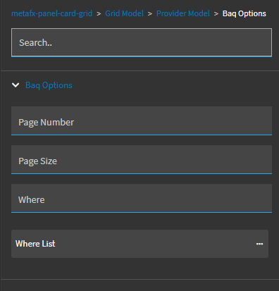

If your data source is not a BAQ with parameters, you could pass the value from the downdown (TranView.Whateveryounameit) through a where clause in BAQ options:
