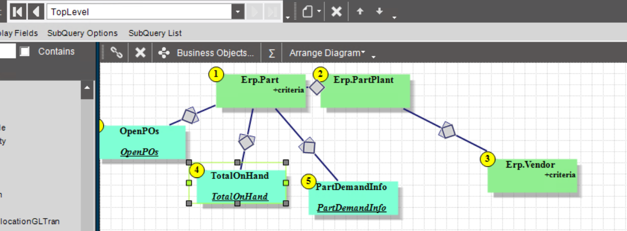

Creating a Go Negative Dashboard
I am trying to create a dashboard for purchasing that has the date a purchased part goes negative and then the next open PO due date after the go negative date. I can get the go negative date. I’m having trouble getting the next open release date after the go negative date. I can get the next open PO but can’t compare it to the go negative date. Researching CTEs were mentioned but I’ve never used one and don’t quite understand.
	[Part].[PartNum] as [Part_PartNum],
	[Part].[PartDescription] as [Part_PartDescription],
	[Part].[ClassID] as [Part_ClassID],
	[PartPlant].[LeadTime] as [PartPlant_LeadTime],
	[PartPlant].[BuyerID] as [PartPlant_BuyerID],
	[Vendor].[VendorID] as [Vendor_VendorID],
	[Vendor].[Name] as [Vendor_Name],
	[TotalOnHand].[Calculated_OnHandQty] as [Calculated_OnHandQty],
	(min(PartDemandInfo.Calculated_ZeroDate)) as [Calculated_RunOutDate],
	[Part].[BuyerPlannerNotes_c] as [Part_BuyerPlannerNotes_c],
	[OpenPOs].[Calculated_NextPODueDate] as [Calculated_NextPODueDate]

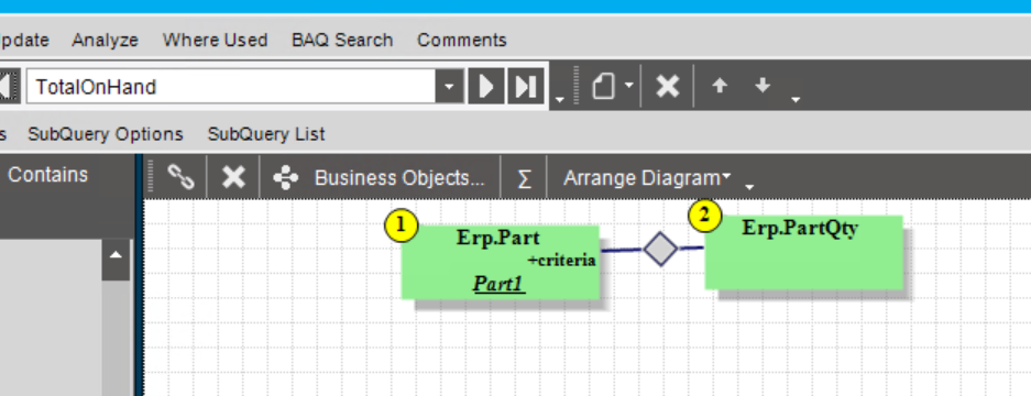

left outer join  (select
	[Part1].[Company] as [Part1_Company],
	[Part1].[PartNum] as [Part1_PartNum],
	(sum(PartQty.OnHandQty)) as [Calculated_OnHandQty]
from Erp.Part as Part1
inner join Erp.PartQty as PartQty on
	Part1.Company = PartQty.Company
	and Part1.PartNum = PartQty.PartNum
where (Part1.TypeCode = 'p'  and Part1.InActive = false)
group by [Part1].[Company],
	[Part1].[PartNum])  as TotalOnHand on
	Part.Company = TotalOnHand.Part1_Company
	and Part.PartNum = TotalOnHand.Part1_PartNum

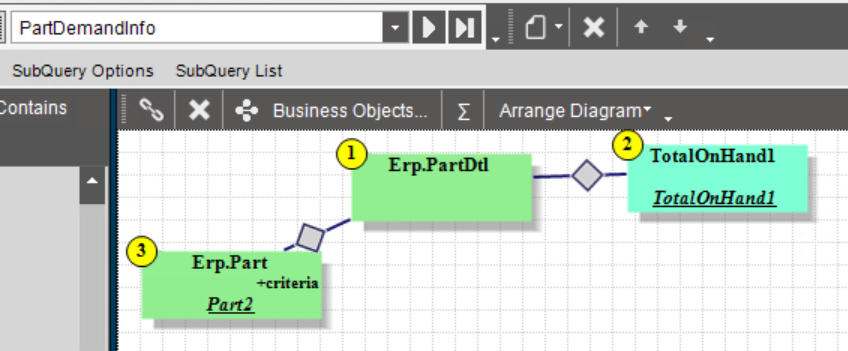

	[PartDtl].[PartNum] as [PartDtl_PartNum],
	[PartDtl].[Type] as [PartDtl_Type],
	[PartDtl].[RequirementFlag] as [PartDtl_RequirementFlag],
	[PartDtl].[Quantity] as [PartDtl_Quantity],
	[PartDtl].[DueDate] as [PartDtl_DueDate],
	[PartDtl].[SourceFile] as [PartDtl_SourceFile],
	[TotalOnHand1].[Calculated_OnHandQty] as [Calculated_OnHandQty01],
	(CASE
     WHEN COALESCE(PartDtl.SourceFile, '') = 'JH' THEN COALESCE(PartDtl.Quantity, 0)
     WHEN COALESCE(PartDtl.SourceFile, '') IN ('JM', 'OR') THEN -1 * COALESCE(PartDtl.Quantity, 0)
     ELSE COALESCE(PartDtl.Quantity, 0)
 END) as [Calculated_DemandQty],
	(SUM(COALESCE(DemandQty, 0))
 OVER (PARTITION BY PartDtl.PartNum ORDER BY PartDtl.DueDate
       ROWS BETWEEN UNBOUNDED PRECEDING AND CURRENT ROW)
 + COALESCE(TotalOnHand1.Calculated_OnHandQty, 0)) as [Calculated_RunningQty],
	(CASE WHEN RunningQty < 0 THEN PartDtl.DueDate ELSE NULL END) as [Calculated_ZeroDate],
	[PartDtl].[Company] as [PartDtl_Company]
from Erp.PartDtl as PartDtl
inner join  (select
	[Part1].[PartNum])  as TotalOnHand1 on
	PartDtl.Company = TotalOnHand1.Part1_Company
	and PartDtl.PartNum = TotalOnHand1.Part1_PartNum
inner join Erp.Part as Part2 on
	PartDtl.Company = Part2.Company
	and PartDtl.PartNum = Part2.PartNum
	and ( Part2.TypeCode = 'p'  and Part2.InActive = false  )
group by [PartDtl].[PartNum],
	[PartDtl].[Type],
	[PartDtl].[RequirementFlag],
	[PartDtl].[Quantity],
	[PartDtl].[DueDate],
	[PartDtl].[SourceFile],
	[TotalOnHand1].[Calculated_OnHandQty],
	[PartDtl].[Company])  as PartDemandInfo on
	Part.Company = PartDemandInfo.PartDtl_Company
	and Part.PartNum = PartDemandInfo.PartDtl_PartNum

You might have to make another subquery. If you have the calculated Negative Date, you can link to a summarized PORel or PartDtl again where you get the Min on all open releases due on or after your Negative Date. I would think that should work assuming that you only have a single release due on a given day. Not sure what I would do if there are likely to be multiple hits there. Once you have the subquery that returns your single record, you can link that back up to your main query to get the details on that PO if needed.
Edit: There could be issues with late releases that are before your negative date that could be problematic for what you are trying to do here.
On a side note, this is exactly what Time Phased Inquiry does. You must be trying to make a mass review version of that?
Yeah. They want to see it all on one screen. Your solution worked. My brain had turned to mush after working on it so long :slight_smile:
