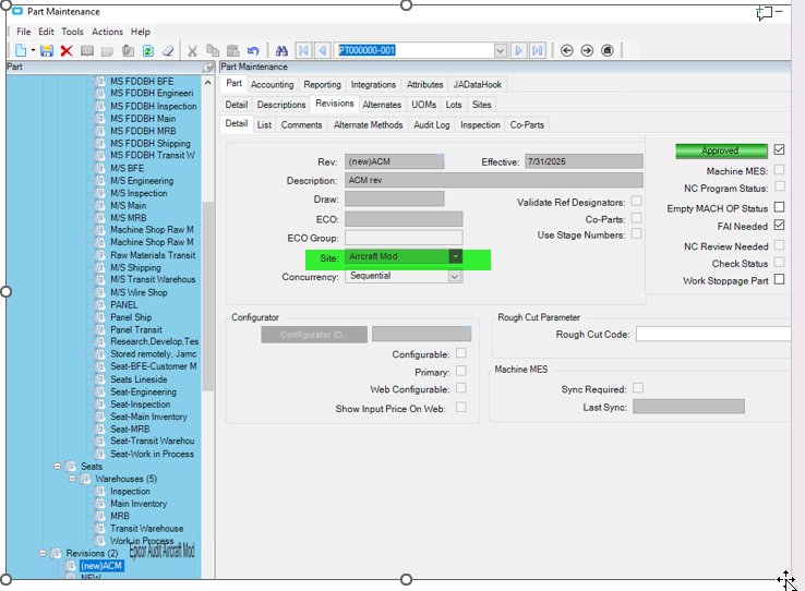

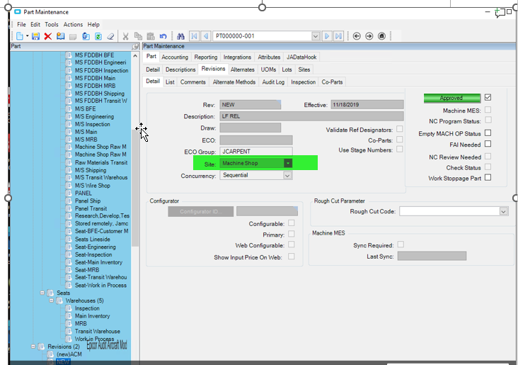

I have an approved rev in both site Aircraft Mod and site Machine Shop -

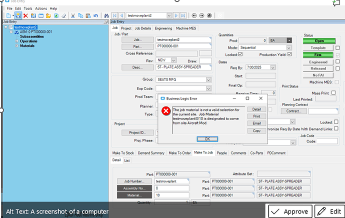

Next, I created a job in the Machine Shop site and tried setting it up as make-to-job to the job I created in the Aircraft Mod Site but I get this error -
I tried reversing the link and still got the same error but saying it is designated to come from Machine Shop..
