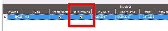

I have an AR Invoce group with just a single invoice (a Credit memo actually). But the invoice is showing as “Hold Invoice”
What can cause this to be set, and how can I clear it.
FWIW - The invoice it applies the credit against posted successfully, a few months back.

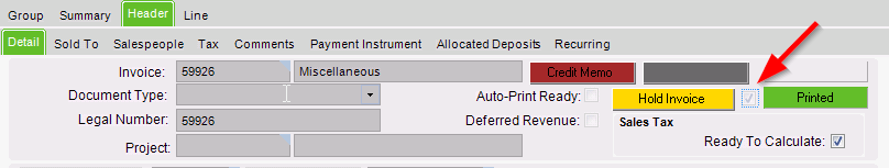

Have you tried unchecking the hold on the header?
ckrusen
(Calvin Krusen)
November 1, 2017, 6:10pm
3
The On Hold checkbox is disabled

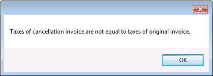

I tried running the Calculate all taxes, and get the following
After closer examination, the one line that should have tax calculated, shows the correct tax amount, on the line tab. Bu that line’s Tax tab shows no entries. Since it’s a Cancellation Invoice, none of the fields in the lines are editable.
