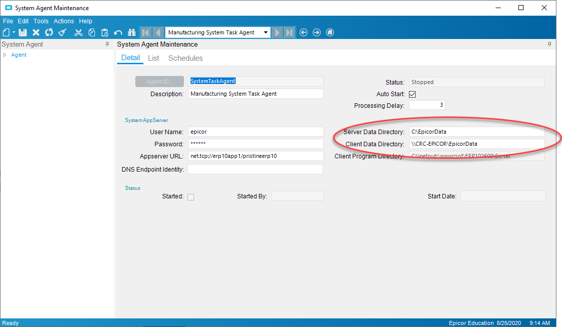

Crystal Not Printing
The report selected does not have any data to download.
//server/EpicorData/Reports/wcremer/BAQ Report-StockReorder (Stock Part Reorder Inform2064862.xml
Ideas? I saw someone say back in 2018 it was in his Company Configuration, but not where are or how.
Are your agent settings correct?
I had split my VM into two of them, but the settings looked correct. What I didn’t have was the CustomReprots folder in the EpicorData folder. Once i did that and put the report sin there, it worked!
