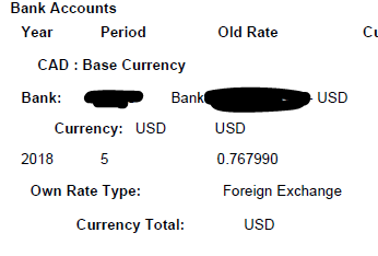

I’m hoping this is a quick answer for someone, I’m trying to find out where the “old rate” on the currency revaluation report for Bank Accounts is coming from. It doesn’t tie to any of our exchange rates, in fact it is closer to an inverse of our rates, but not quite, and seems to jump month after month.

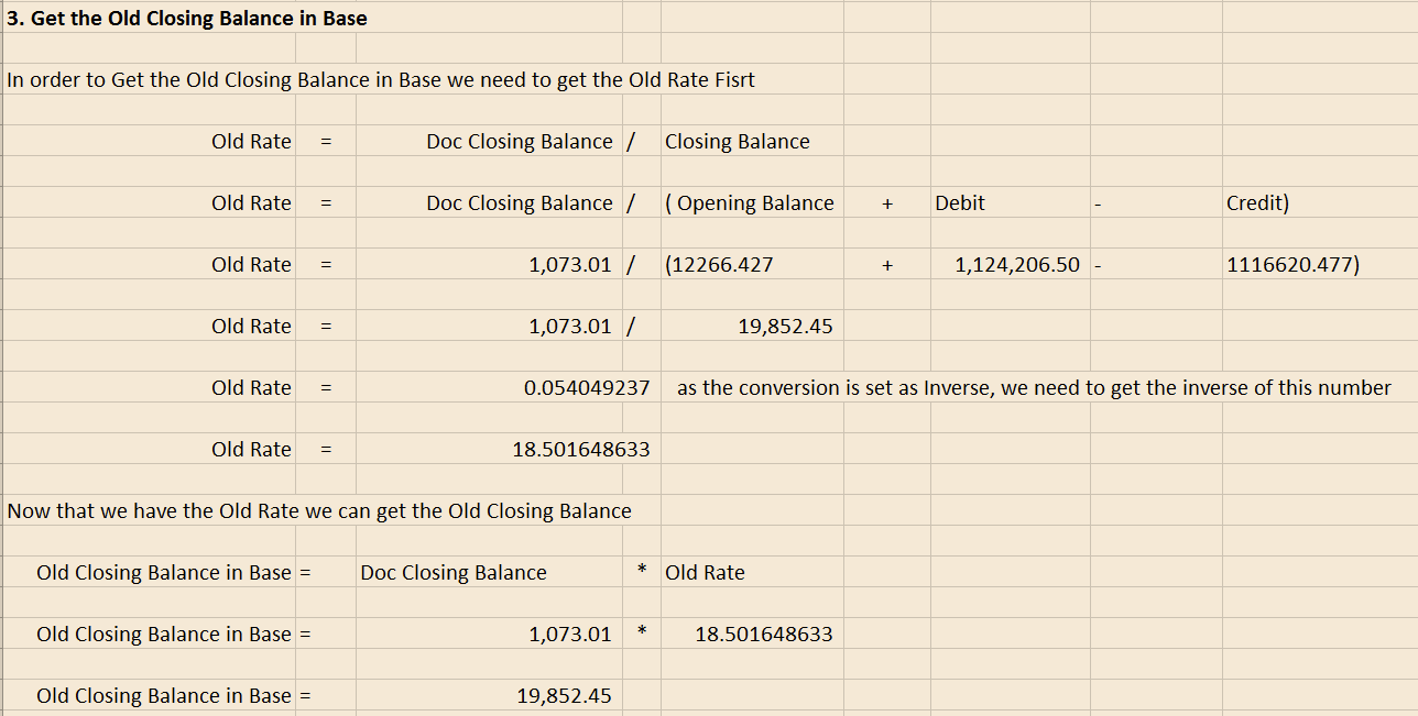

For anyone curious, Epicor responded with the below image in terms of how the “Old Rate” is calculated. However, I still can’t quite prove the rate out, and the bank balance was still not reflective of our actual bank balance. After some testing I’ve discovered that I needed to “recalculate bank balance” to reflect what is shown in our bank statement processing. However, when I run the Currency Revaluation report or the G/L Currency Revaluation report, no exchange is applied on the amount. Additionally, it doesn’t factor in the items processed but not yet cleared (outstanding items on the bank statement processing report) for the overall bank balance. Does anyone know anything about this that might help? Am I missing a step to have the revaluation report calculate exchange? Does Epicor just not factor in outstanding items in the bank balance or is there another setting I should be looking in to?
Edit: never-mind, the exchange is being applied now, but still the old rate I’m not sure of.
It looks like Epicor is removing the “old rate” from the report in a future update.
