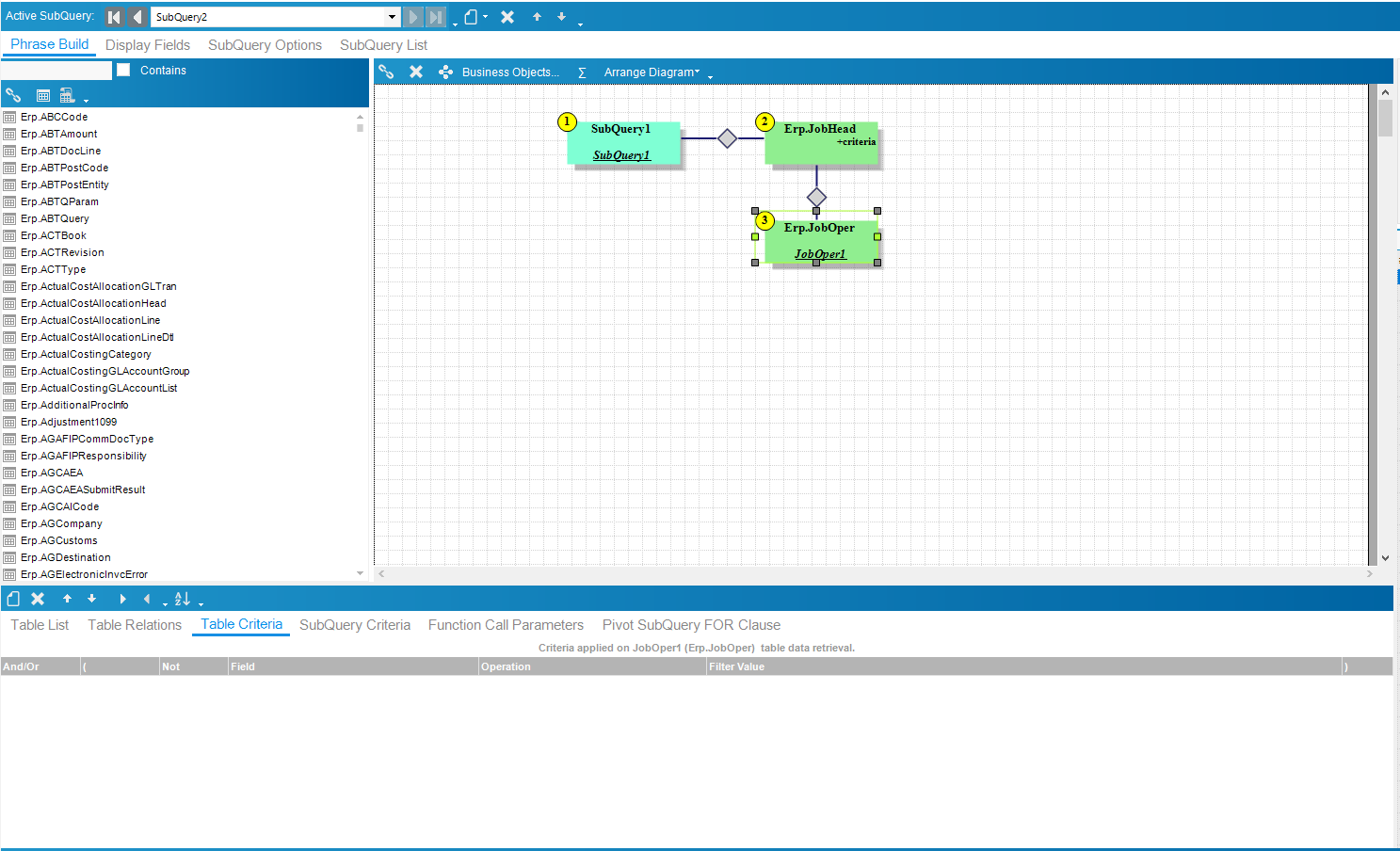

the first query is marked as CTE with the joboper table. Following the steps the query returns the exact rows that I need with only the JobNum and calculated OprSeq field. I am wanting to add the operation description field on the top level as just the sequence numbers do not give much info on the current operation. When adding the JobOper table and OpDescription field to my top level query the BAQ is now simply returning all operations to the jobs. I have messed with joins and such but have currently came to a dead end. Any thoughts? @jkane Maybe you could help? https://www.epiusers.help/t/baq-current-open-operation-only/38616

If you need data from it, it should be the third table. Join the CTE to JobOpr on Company, JobNum, and OprSeq and set the join to contain all records from the CTE (left outer join). Then join JobOpr to JobHead on Company and JobNum and set the join to contain all records from JobOpr (left outer join).

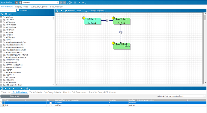

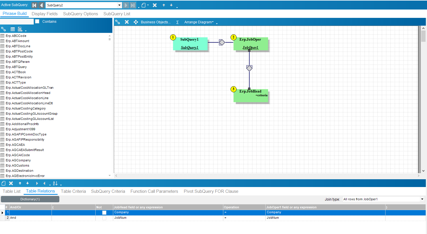

I attempted this assuming this is what you meant, but this was ignoring my criteria set on JobHead (assuming because of the join type to JobOpr). It was pulling records from all jobs it seemed.
However, I obtained what I needed by adding a matching join between JobHead and the CTE and changing the other joins to matching. Not sure I understand the logic behind that but it worked.

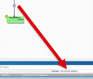

Your join is going to the wrong way. You have it set to “All Rows from Job Oper”. you want matching rows, or “All Rows from JobHead”
