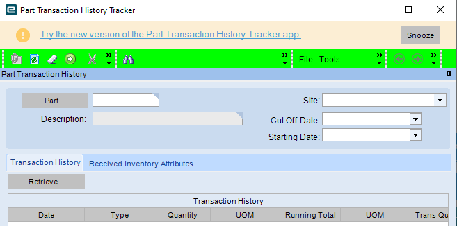

I’m starting to work on how to set the default cursor start position when opening a form. One form that I do not have customized yet is Part Transaction History Tracker. By default on our version the cursor is nowhere. We would like it to be on the part field. To be nice I decided to look into this.
Tab Index is already set to 1. I’ll let you know what I find out. Feel free to offer a solution.

This is the properties of the field.
