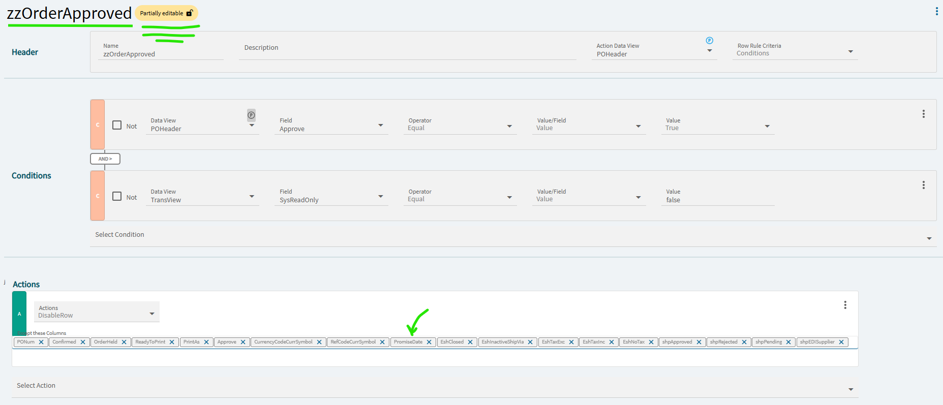

Think its this one. It says “partially editable”… so try adding in your UD column to the exceptions and see if it will stay awake.
It works! thank you David!

It doesn’t seem to. I just tried adding DueDate to the list of exceptions but it still remains read-only on the form. I’m assuming there must be other rules/logic in play because adding it here doesn’t seem to do the trick.
@andrew.johnson, how did this zzOrderApproved work on your PORel UD field? Doesn’t this rule only work on POHeader fields?
I have a similar situation with a UD field for PORel table that becomes read only when a PO gets approved. There are 2 other rules that potentially can do the trick. disablePORelApprove supposedly accepts some changes but does not save my column in the Actions exceptions. On the other hand disablePORelView allows to save the added column, but does not keep my field editable after a PO is approved.
