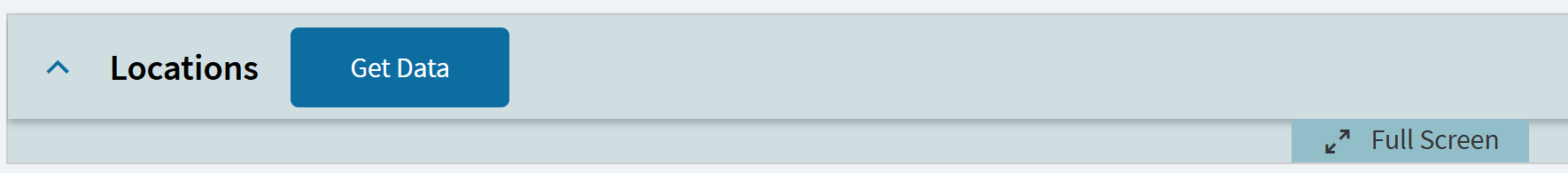

The customization will work as intended, collapsing and expanding the panel card grid correctly in Application Studio. But when you do the same from a menu-launched item, you get something that looks like this:**
This can be remedied by clicking the little arrow to the left of the header twice (once to collapse the panel card, once to expand the panel card) after the event is done running.

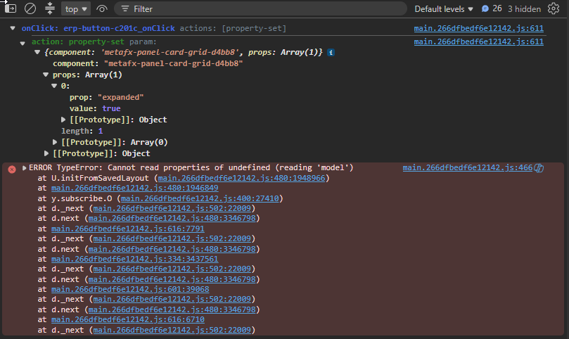

I happened to face the same issue yesterday on Public Cloud 2026.100.9 in Pilot. In short, when the panel card grid was expanded with “property-set”, some error occurred saying the “model” property was undefined.
Manually expanding the panel card grid by clicking on the little arrow worked, so I thought why not I just simulate the click event using Javascript, and then it worked lol. You can try the workaround below and see if it works for you. Not sure if introducing delay with “dashboard-timer-set” and “dashboard-timer-clear” are still required but since it worked for me I just leave it as is.
