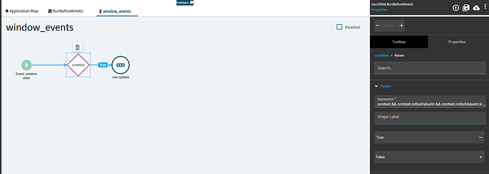

  6. Edit the window_event, Event: window after. Add a condition:
    With the expression: context && context.initialValueIn && context.initialValueIn.ValueIn

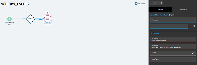

  7. Add a row-update on the True branch:

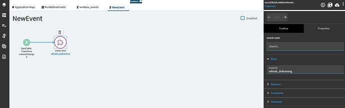

  8. Add the event to refresh the form when editing the part number field.

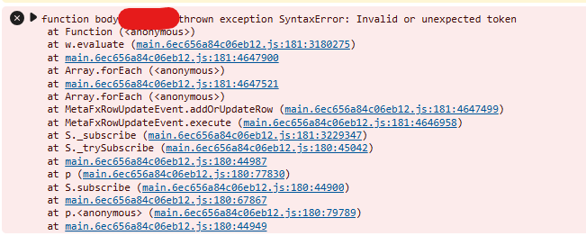

So It works perfectly for some part numbers, but for others it pops a slideout error saying “Invalid or unexpected token.”
I can use the same part entry screen and with one part it works, another part it doesn’t work. When it pops that error I can see in the dev tools: I marked out in red my part number. It was listed right there. If I have the dashboard open already, then I can use the text box and pull that part number, but it doesn’t seem to work when I right click it. There are several parts that do and do not work. I can’t tell why some do and some do not.

It seems like part numbers that contain letters produce that error. :thinking:
Interesting when I passed part number that contained a dash, it truncated it at the dash so it only includes numbers. I am not sure why…
Does something in the expression strip characters?
Edit I have set my data type to string but it didnt help.
So when my part number has a dash, it acts like a subtract. So for part 9620-308, when I right click and open with my dashboard, I get part number 9312 instead! Any part that has a character wont load at all in my dash and just gives that error: Invalid or unexpected token. I think something must be converting my strings into ints. I can’t tell where this happens. Perhaps in the way I am assigning the value in my BAQ options: JobAsmbl_PartNum = ‘?{TransView.PartNum}’ Or in setting the PartNum to Value In: %session.context.initialValueIn.ValueIn%
I fixed my row-update widget to use this expression with double quotes around the whole thing:
"%session.context.initialValueIn.ValueIn%"
This worked!!
Nice job Nate. glad its working. yeah there are some bugs in the parser causing plus signs to concat and minus signs to subtract and number treated as text, etc.
FWIW, clicking on the top most link in your console error and putting a breakpoint in w.evaluate is how I usually figure out what the expression syntax eval is doing.

Can you tell me more about what the condition: context && context.initialValueIn && context.initialValueIn.ValueIn does?
Is it like, context exists, initial value in exists, and the value is valid?
Yeah. Exactly. so in javascript you’ll get an error trying to get the property of an object that doesn’t exist so common practice is to check for existence up the chain to property. The check will bail and return false instead of error upon first non-existence so it’s safer that way. The property you want is .ValueIn but let’s first make sure it’s parents are there.
