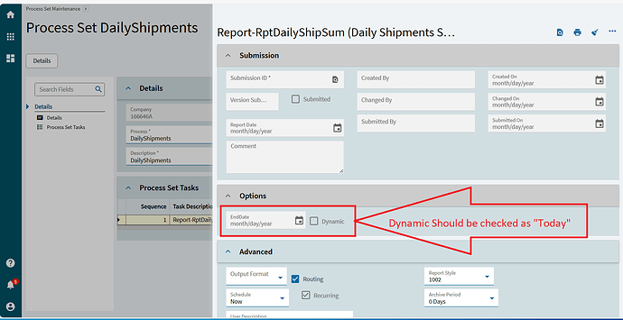

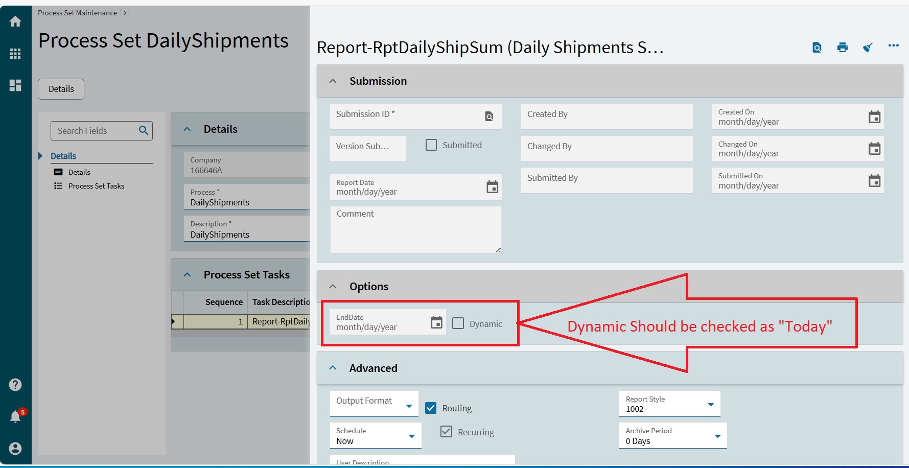

MS. @aosemwengie1: Thank you for the reply - I just tested my RDD as a direct submission to the task agent AND saved to a “Process Set”. In both cases when Check the “View Task Parameters” the date Dynamic field is NOT checked. Aaaaarg! Must be something i am doing.

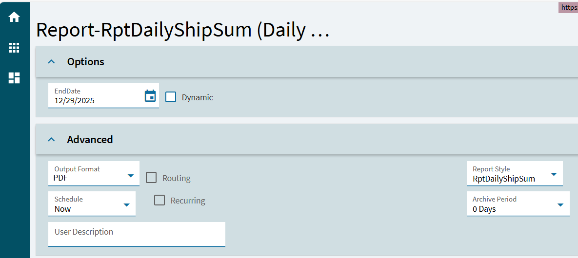

What does it look like when you are actually submitting the report? This looks like its been opened from within the existing scheduled task. I mean if you put your report on the menu, and then go launch that menu item.
This is what it looks like when launched from the Memu.
It runs correctly if i select the Dynamic and Today options.
However, when i submit this to either the Task Agent or to a Process Set the report runs with whatever day the report was submitted. i.e. all of the scheduled reports will run daily but they will ALL use today 12-29-2025 as the date parameter.
