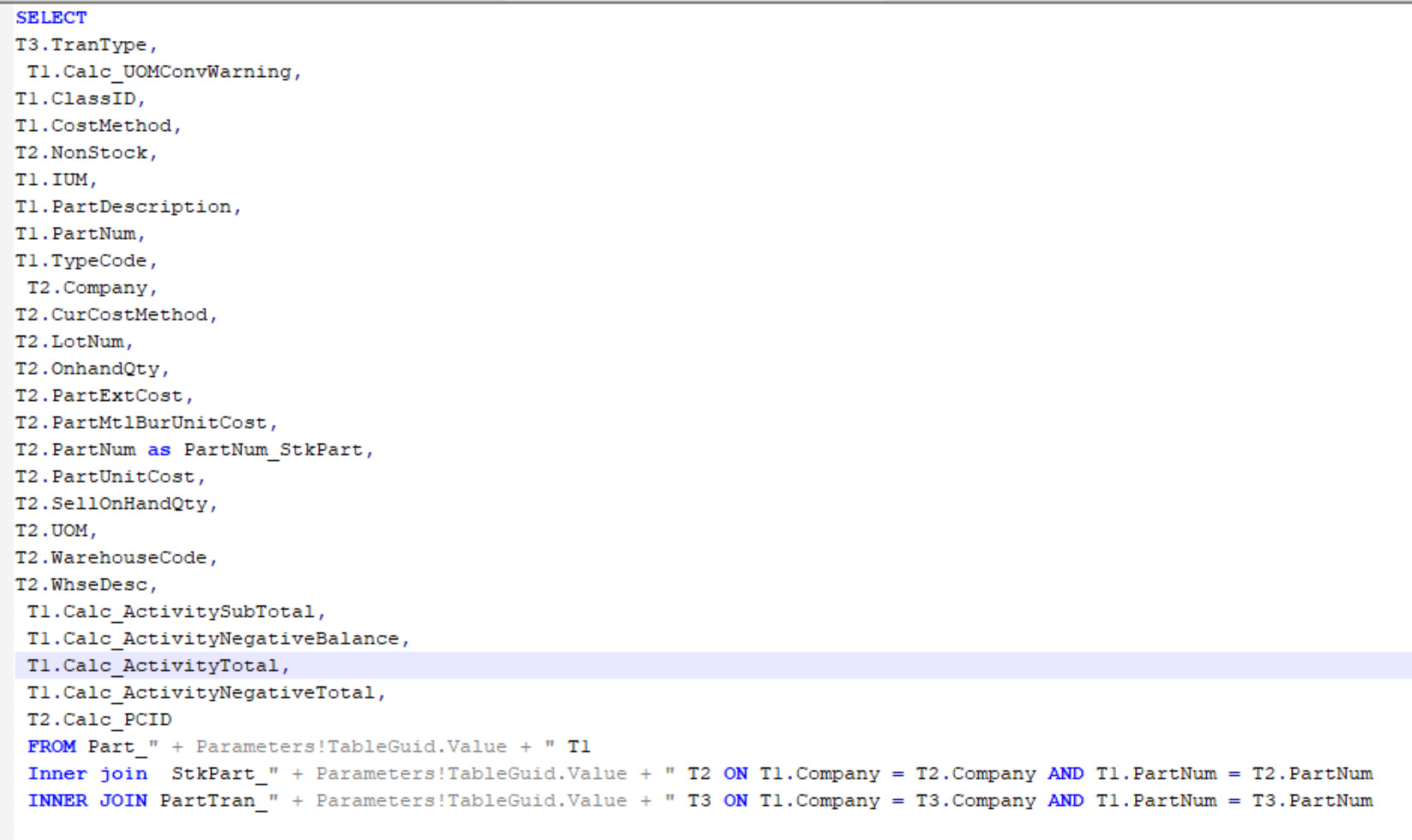

And my organized code: (I can post my actual code too, I just thought a picture might be neater)
The only two parts that I have added is adding the T3.TranType variable along with the final inner join with PartTran and Part. If I get rid of my parts of the code, it runs fine.
Thanks again for any help!
