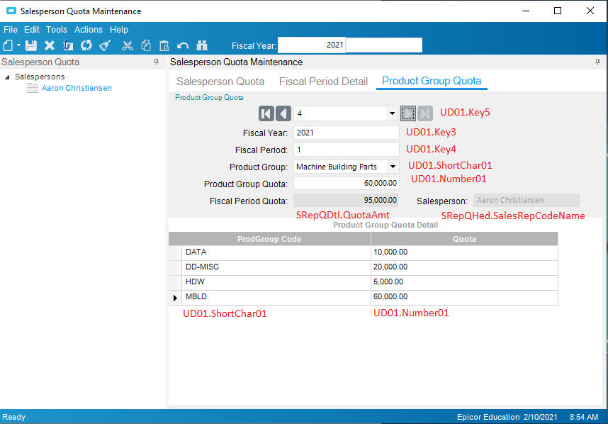

What is the best way to custom the Salesperson Quota, to be able to assign a quota per product group?
I plan to use UDtable and bind it with these fields:
SRepQHed.Company
SRepQHed.FiscalYear
SRepQHed.SalesRepCode
Any ideas to help me achieve this, thank you in advance!!
In a customization, use the wizard to add UD table as child.
Key=FY
Key2=SalesRepCode
In the grid you will set
Key3 = ProdGroup (dropdown)
Number01=Quota

This is the code generated by “Add User Defined Tables As Child Wizard”, I only add “oTrans.Refresh();” to “SaveUD01Record()” method to refresh the GUI after Update the SRepQDtl.QuotaAmt through Post-Processing BPM.
The delete button doesn’t work in UD01 Table entry.

The UD01 fields are populated correctly in the DB, this is my mapping fields:

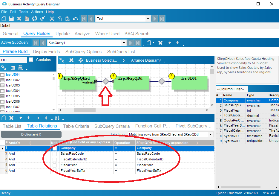

if I join the UD01 table with ERP.SRepQDtl it works fine:
