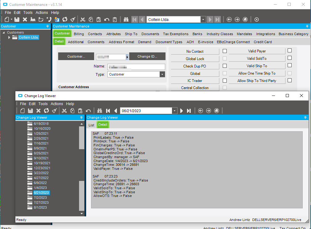

We have 4 or 5 customer records in which 9 checkboxes have mysteriously changed from true to false, rendering the customer mostly unusable until they are reset.
the fields are:
Customer.ValidPayer
Customer.ValidSoldTo
Customer.ValidShipTo
Customer.AllowOTS
Customer.PrintAck
Customer.PrintLabels
Customer.GlobalCreditIncOrd
Customer.OneInvPerPS
Customer.FinCharges
They show in the Change Log. The user shown in Change Log has not unchecked the boxes, They would have had to make the changes on three separate tabs of the customer within 10 seconds, and that does not seem likely, and they insist that they do not ever change all those checkboxes.
So, what could cause these fields to change?

I never got a resolution to this mystery. Epicor Support checked with Avalara Support, and both said their software would not change those values. Without reproducing it, they couldn’t troubleshoot any further.
It did recur once in our db for the same 3 or 4 customers about a month or two after the initial discovery. But, again I couldn’t trace it to anything in particular. It has not recurred again.
@alintz , I ended up creating a data directive to throw an error and prevent the fields from actually changing.
I’ve had 2 users report the error message since then, but all I’ve learned from that is it likely has something to do with pulling in multiple customers into Customer Maintenance and switching from one to another. Maybe some weird permutation of the nav bar arrows and the Save, Refresh, and Clear buttons (possibly interacting with some quirk in the datasets of the customers pulled into Customer Maintenance), but I still cannot recreate it on demand.
I still hope to get to the bottom of this but at least for now the data directive is stopping all the chaos that had been ensuing from corrupted data.
