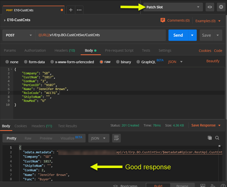

I’m trying to make a REST call to https://xxxxxx/E10Live/api/v1/Erp.BO.CustCntSvc/CustCnts
to update a contact. The rest call works in our testing environment no problem. But when I call it against the LIVE database it fails. Looking at the event log on the Epicor server we get this:
System.Data.Entity.Core.UpdateException: An error occurred while updating the entries. See the inner exception for details. —> System.Data.SqlClient.SqlException: Violation of PRIMARY KEY constraint ‘PK_CustCnAttr’. Cannot insert duplicate key in object ‘Erp.CustCnAttr’. The duplicate key value is (SD, 1817, , 2, ).
The statement has been terminated.
Why is the BO trying to create another record in CustCnAttr instead of updating? This is weird because the same exact payload is working against the other slot with the same exact data! What is different about this table in live?

For simplicity (and proof of error) I’m using POSTMAN to do the requests.
Working:
Not working:
server error on the fail:

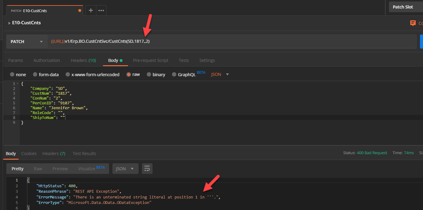

I’m trying to use PATCH now. How do you specific a blank string? The Customer Contact in the database has a blank ship to num. Meaning the contact lives at customer head.
Is forcing the ShipToNum an oversight by the BO that’s doing the REST?
I tried putting nothing there, null, a space, 0, empty quotes, nothing worked. Is there a way to say this contact lives at the customer head level in the PATCH?
