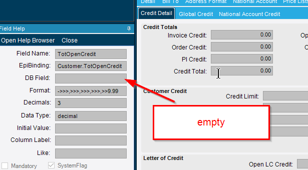

Has anyone had success in getting the Total Open Credit field into a BAQ?
Field help has it as Customer.TotOpenCredit , but I was unable to find in the selection of fields.
Thank you.
When the DB field is empty in field help is usually means that this is calculated on the fly and isn’t in the database in that form. So for you to get that, you would have to calculated it yourself.
I did this long ago, before SubQueries existed. Here are the calculations that I performed, in SQL Views and then brought them all back into 1 to use as an External BAQ.
