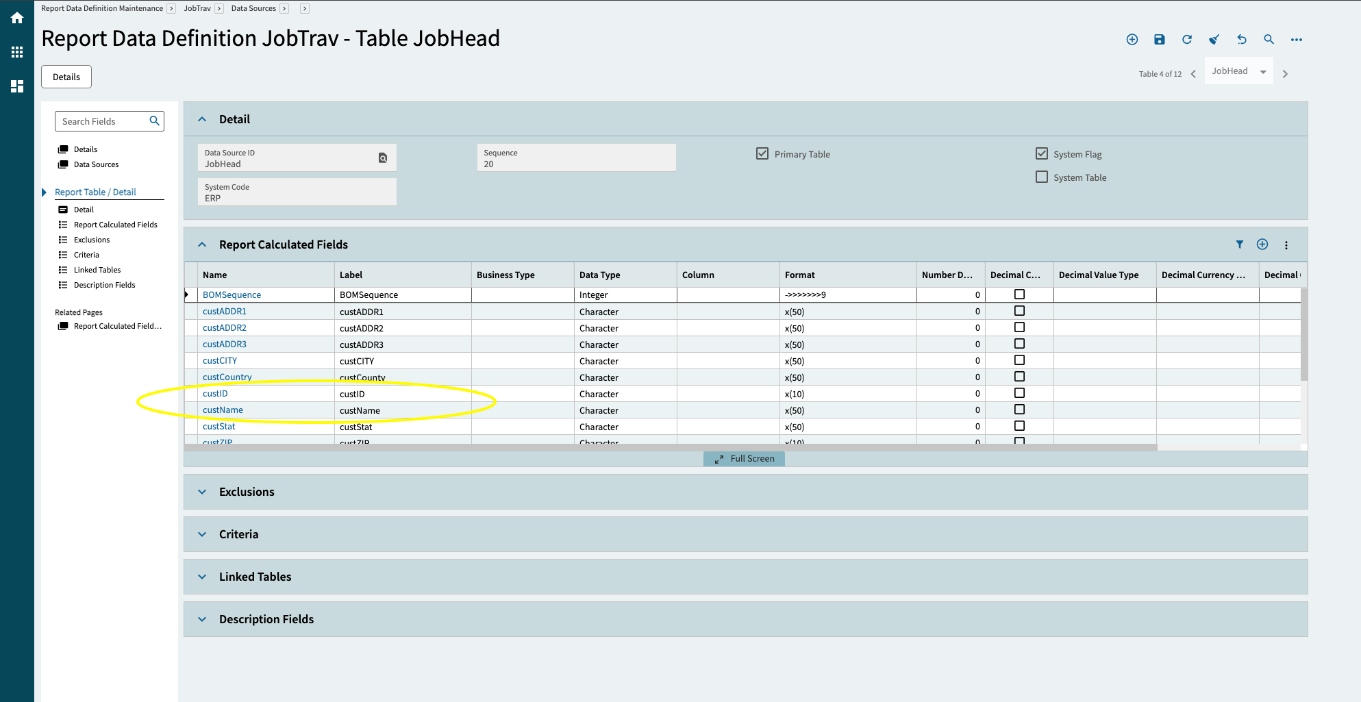

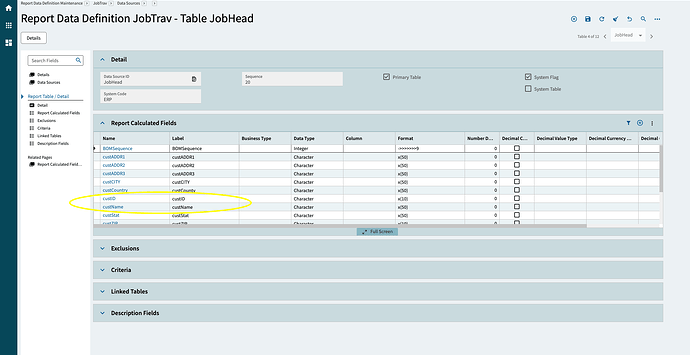

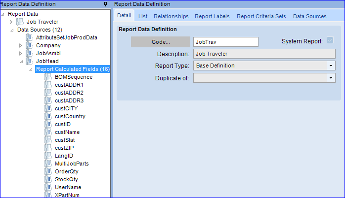

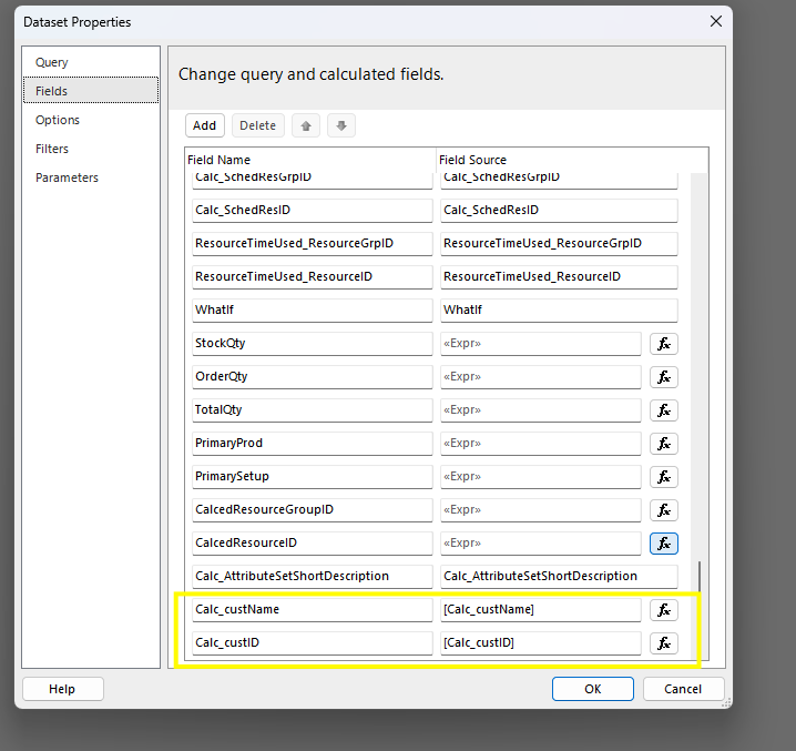

JobTrav already includes customer “calc” fields under the JobHead table.
They’re in the RDD:
But if I remember correctly they were NOT included in the stock RDL. So you have to add them to the RDL query and as query fields, then you can use them.

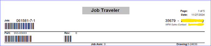

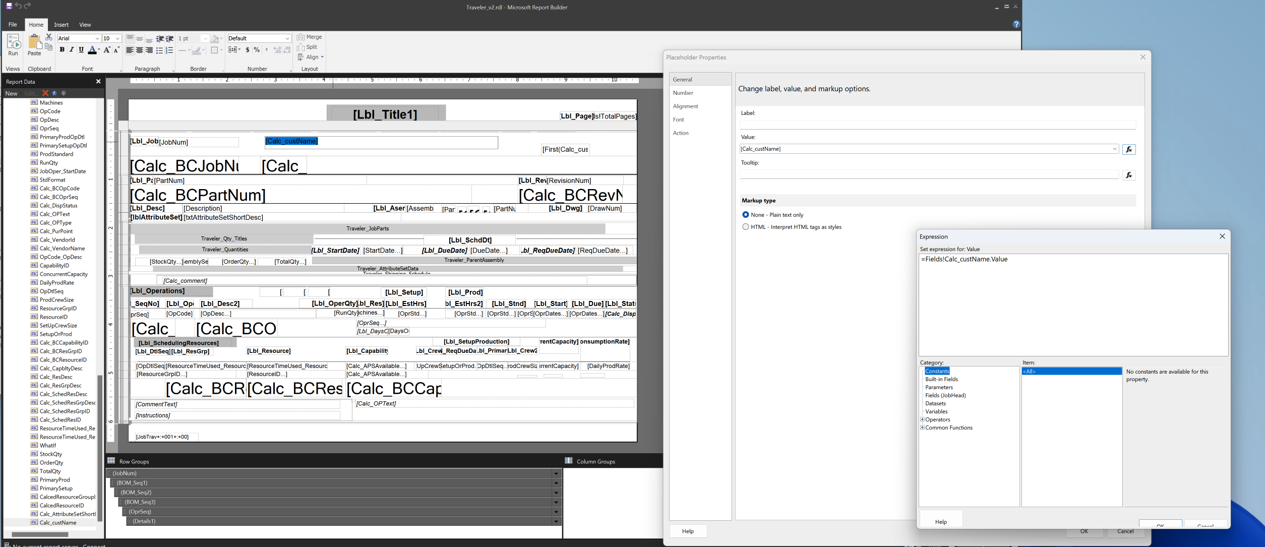

HI Mate could you break this down for me the report currently looks like this but im not getting anything showing up ion the travelers where i have the customer field

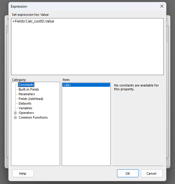

Did you add the column to your query?
It is on JobHead, so would be T1.Calc_custName.

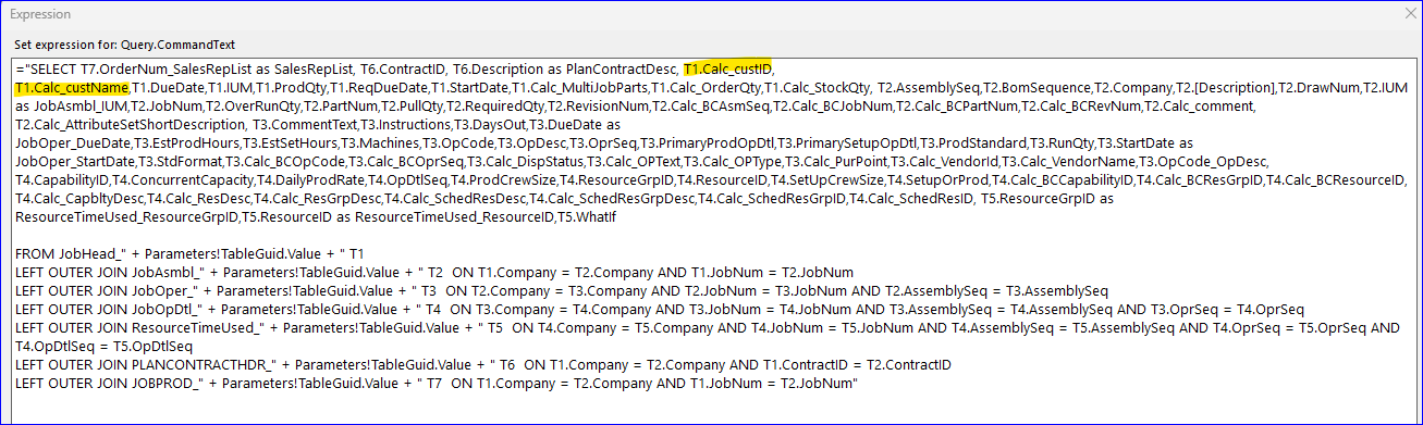

In case it helps… here are some snips from my set-up:
RDL Query:

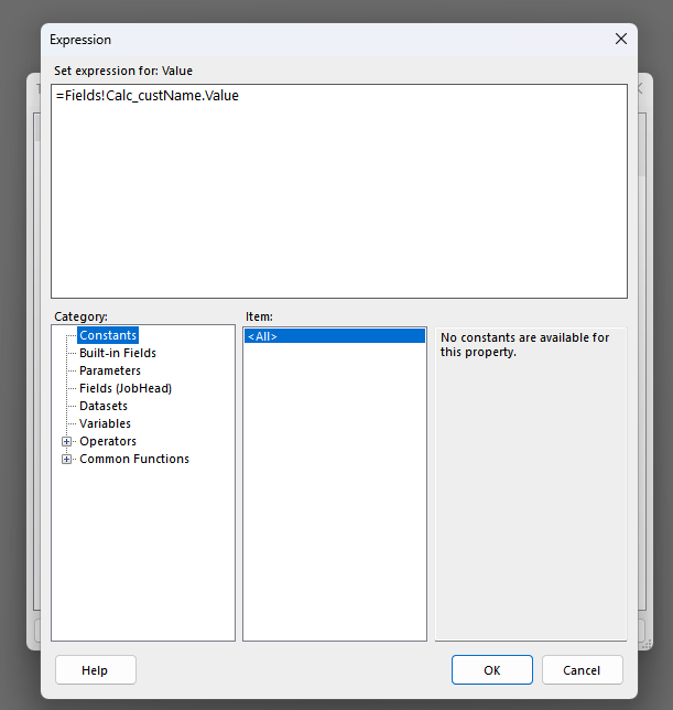

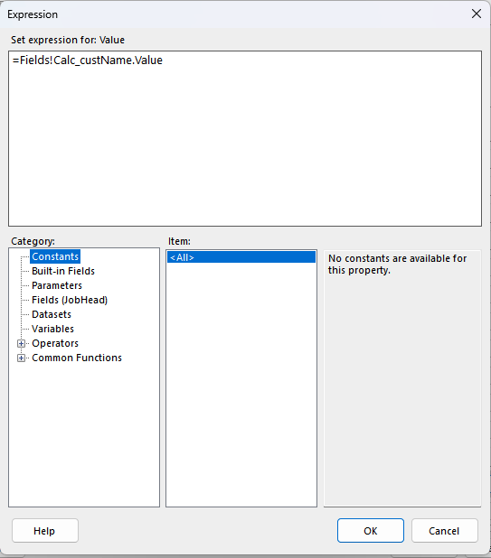

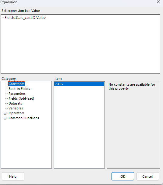

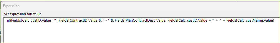

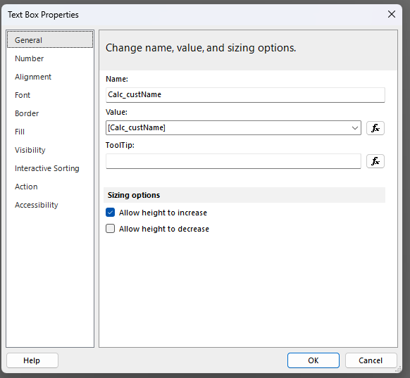

Field Expression:
My set-up is a little different as I’m also setting it up to show a ContractID

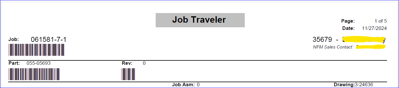

Result:
