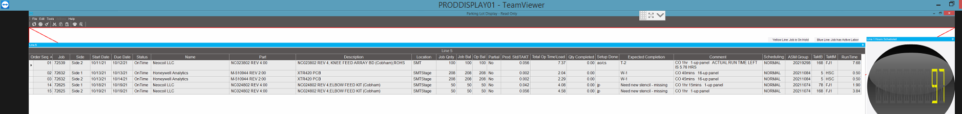

This may be more of a C# issue than Epicor, but I’m struggling to understand what part in the Epicor dashboard is breaking. I have a dashboard with 7 tabs. I’m using a BackgroundWorker to cycle through each tab after 30 seconds, assuming it would be safer and be more stable to be timing on a different asynchronously. It cycles fine, for about 1 and a half to 2 cycles through. Then it will error out with this exception:

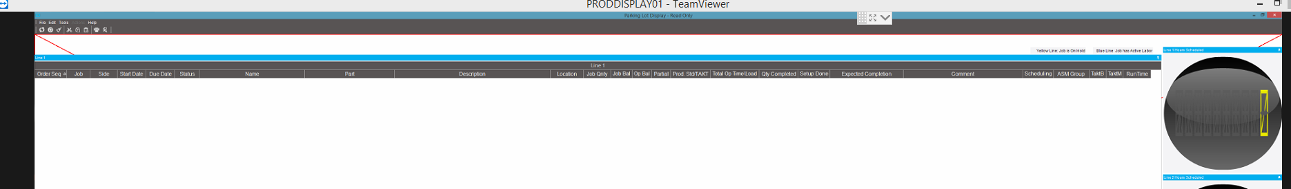

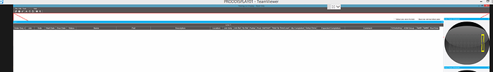

I’m not really sure what’s up with this, because it appears that it’s the ViewListPanel that is erroring out. It disappears and the tabs disappear, and it instead becomes white with a red X through it, like a display error, or more familiar to most of you, like the red X you get when you don’t fill in a mandatory dropdown field in Business Activity Query when adding a new row in the designer.
Then it will continue cycling until the end of the cycle, and I’m not sure if it’s on the updatable query refresh that the grids start returning empty. Do grids get destroyed after an updatable refresh?
*update, it isn’t at the end of any specific cycle, or after any specific query refresh, the query (not the grid because I have gauges zeroing out as well) randomly starts returning no data, sometimes many cycles after it throws the exception.
