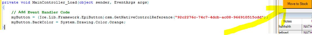

I use this code to change button colors:
public class Script
public EpiButton myButton;
private void MainController_Load(object sender, EventArgs args)
// Add Event Handler Code
myButton = (Ice.Lib.Framework.EpiButton)csm.GetNativeControlReference("92c2276c-74c7-4dcb-ac08-966910515cdd");
myButton.BackColor = System.Drawing.Color.Orange;

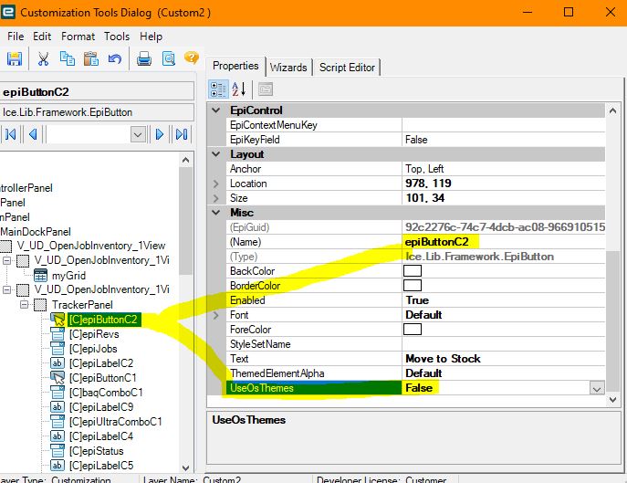

To make this work, you have to change the property of the button: UseOsThemes = false.

Did you check for this property?
