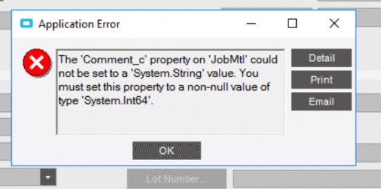

I have a customization that triggers off of an AfterAdapterMethod as per the below. A custom field which is not anywhere in my code always error’s out when I am on our SSO application pool. When I am on the normal application pool, it does not error out. The error i get is:

Also make sure Comment_c is indeed a String, double check it wasnt set by accident to Int.

The code doesn’t reference Comment_c at all. I can confirm in the udcolumn maintenance that it is still a string. If there was a variable type issue, would it not create an error on both application pools, not just the one?

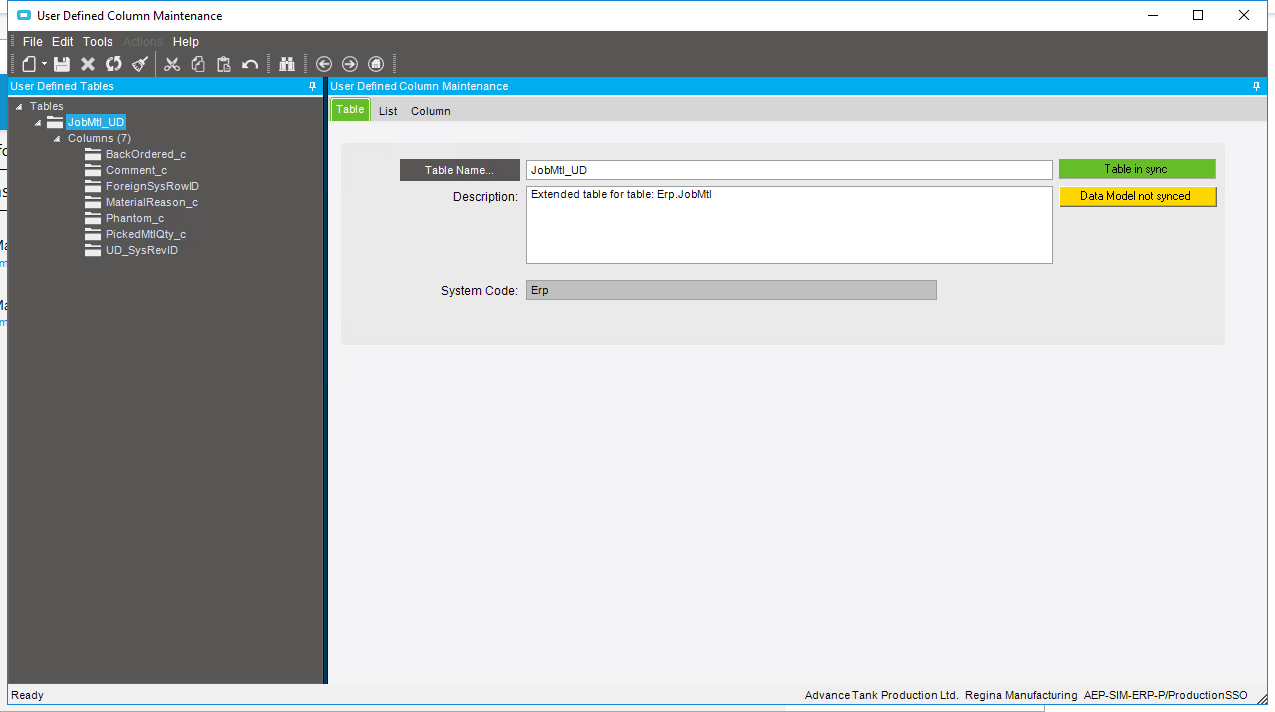

Can you double check in UD Columns Maintenance on Table JobMtl_UD what you have. Worst case I would regen again. Because its enough for the Comment_c to exist in UD Columns Maintenance with wrong type or default value, despite you not using it, it still intializes the DataTable on the UI behind scenes.
Also once you check UD Columns Maintenance, XML you said you checked, you can also post the “Details” of the error. Stack Trace.

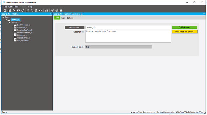

Well thanks for pushing me to triple check… JobMTL_UD is not in sync. I checked this multiple times on the weekend before we went live and this was synced. I did check this from the Production application pool instance of the Epicor client though, not SSO.
Check your Comment_c types, settings… and atleast you have something to work with… Remember to Recycle all Instances and perhaps redo Regen on or something odd
