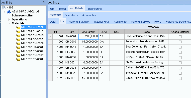

How do I get to list view? I can see the tree on the left, but I cant move anything there.
Thanks in advance.

Do you mean Job Details\> Materials\> Details vs. List tab? If so, I think you would need to uncheck Engineered and Released.

In the GIF below,
1. I created a new Mtl record (via Right click and “Add Material”)
2. After Seq 1030 was created I hit tab once to get to the PartNum field
3. Enter the Part Num and hit tab. This takes you to the Qty/Parent
