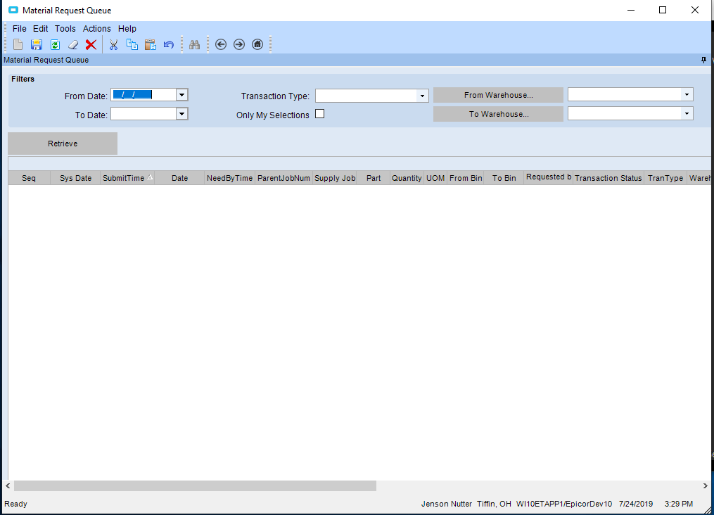

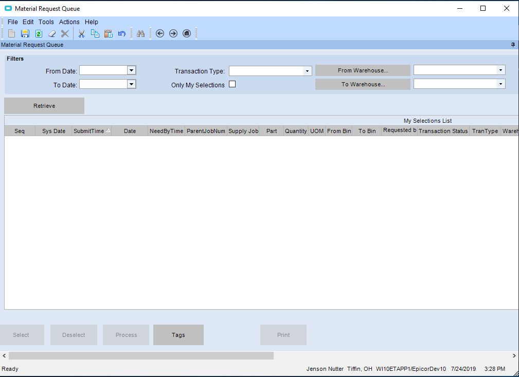

Below I have attached a picture of Material Request Queue on the first open after a cache clear and then a picture of Material Request Queue after closing the form and immediately reopening it.

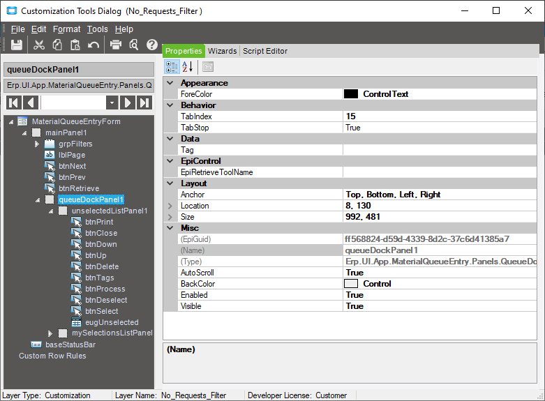

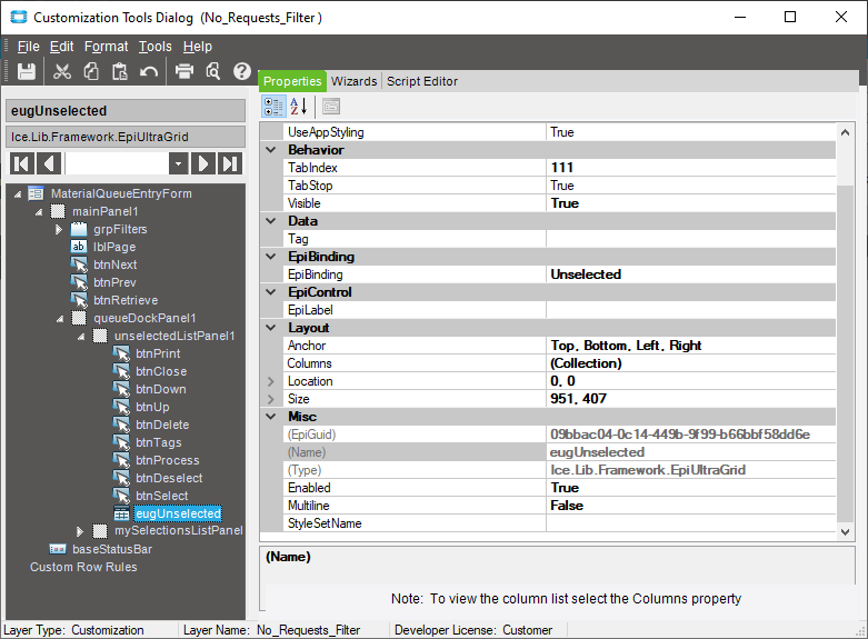

I had the same issue while formatting our Mtl Queue layout. I had to turn off all anchoring down to the grid, blow the form up to full screen, set the layout how I wanted, turn anchoring back on, shrink the form to preferred size. Then save the customization, close the customization screen, save the layouts while in dev mode, close the form, clear cache then test outside of dev mode.
It wouldn’t stick for me until I saved the layouts, after formatting the form, while still in dev mode. Not sure why.
Below are pictures of the sizes and anchoring I set, from the grid up.

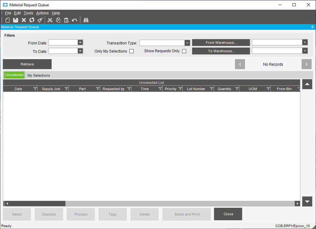

My end result looks like this:
Hope this helps.
