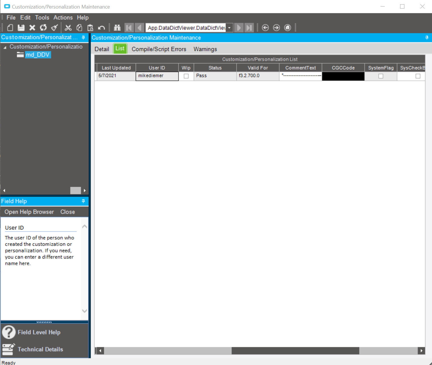

Try Customization Maintenance -
Click the “Name” button in the form.
In the search window, change Type to “Customization”
This will populate a list of customizations (might need to select Options < Return All Rows if there are more than 100 results).
The list returned from the search also shows the Form ID, which should correspond to the form the customization is on (AR Invoice).
Once you’ve found the customization, you can find the UserID of the person who created the customization in the “List” sheet.
Hope this helps!
