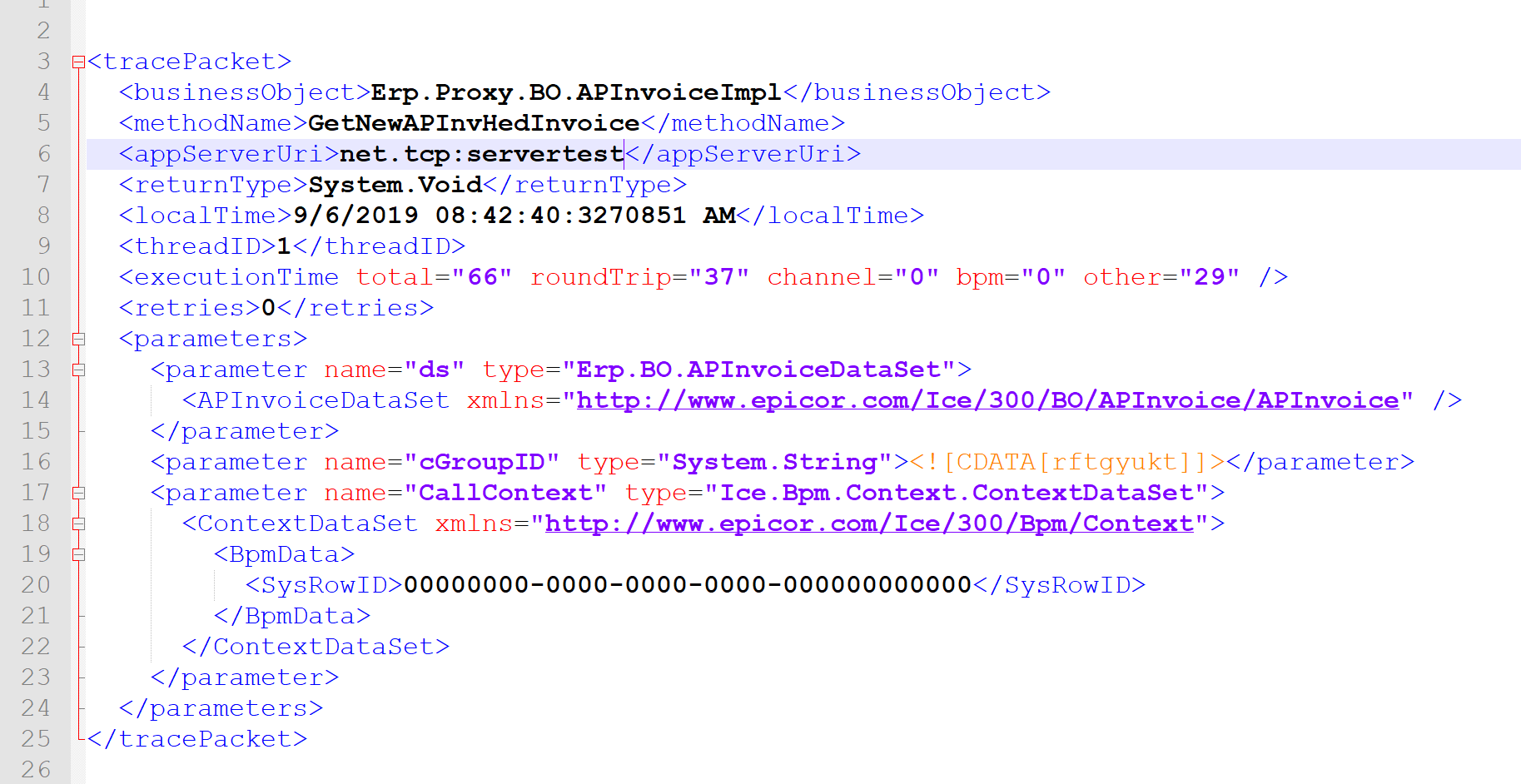

So the question is When I got tracing data i got some Business Object with struct like: Erp.Proxy.BO.xxxImpl how can i recognize which Adapter is used?
if you have any document talking about this. pls suggestion it for me. many thanks.
