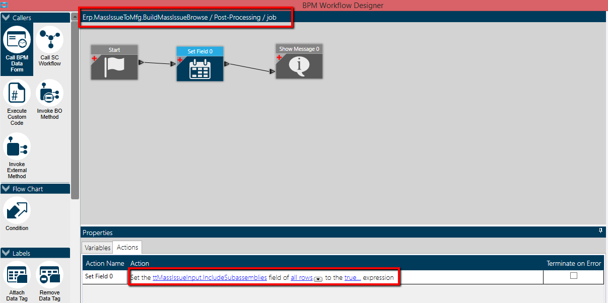

@brandon : I have tried this for u, assuming that you have to set Include Assemblies = true ,by default on mass issue screen.
BO- massissueToMfg
method - BuildMassIssuebrowse
Type- Post Processing
Assumed, there is no condition and u want always set chekBox to True where JobNum != null.
Start - > Set Field -> Info Message
Plz select table ttMassIssueInput table ,and rownum # 5.includeAssembles field
After clicking on Issue Button, ur task is over ,a messgebox can set to give idea to user that, assembles are included,they can change it.
plz ignore some typos.
Plz let me know if it is helpful… :slight_smile:

Hello Prakash,
Your example worked for me but only when I attached it to a pre process instead of post. What was happening in post processing was the checkbox wouldn’t set until after I clicked on issue so I would have to go back and click on the issue button again.
Anyways, thank you very much for the solution as I was having major difficulty because this method didn’t show up in my trace.
