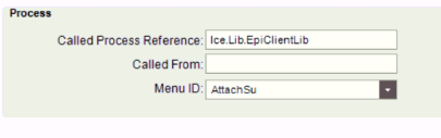

This my setting for Process Menu. The customization name is the same of supplierentryForm and for AttachmentDetailForm. what should i change?
I’m not sure it’s possible because normally the “Subform” resides in the same library in this case the library for attachementDetailForm is different. The form is contained in the Lib.Attachments.Attachment Detail Form

When you do something that launches a sub form - when developer mode is enabled - you’ll get a pop-up telling you the process menu that was called. That info will guide you to the “process menu” that needs to be updated.
And those subforms that don’t have a menubar to access “Customize”. you would right click in the form and enter customization mode from the pop-up menu.
And make sure you close the client and re-launch it to see the menu changes take affect. (switching users also works)
Is this what you’ve done?
edit
maybe you need to do this
This is valid for the SubForms that are called by a process call, in the case of the AttachementForm it is not called in this way in fact the message like this is not displayed.
