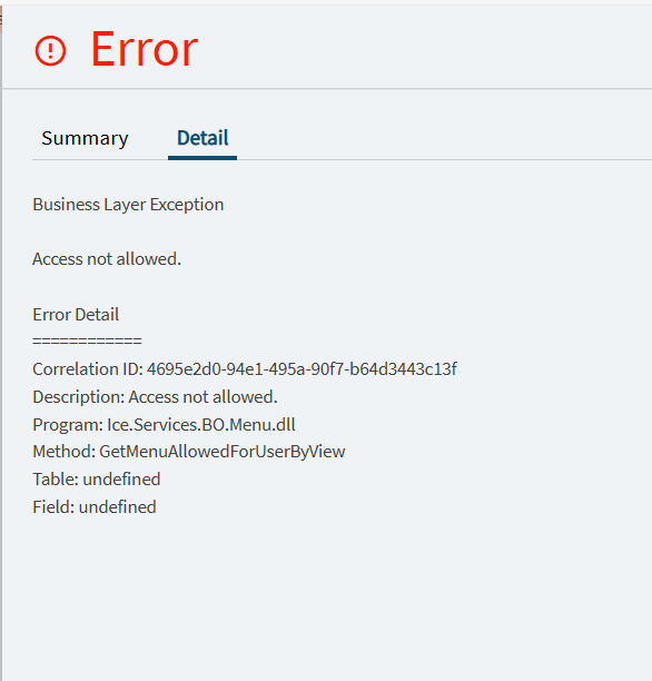

Has anyone been able to successfully customise/apply a layer to Method Tracker at all please?
Opening from the main menu works without issue, an error appears when I right-click the part revision to access method tracker from the context menu.

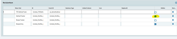

As a workaround, we have now created our own Context Menu and hidden the standard Method Tracker
I have come across the same issue. How do you hide the standard method tracker? I don’t see it in context menu maintenance under partRev.RevisionNum

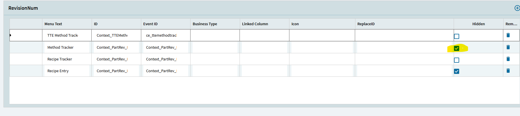

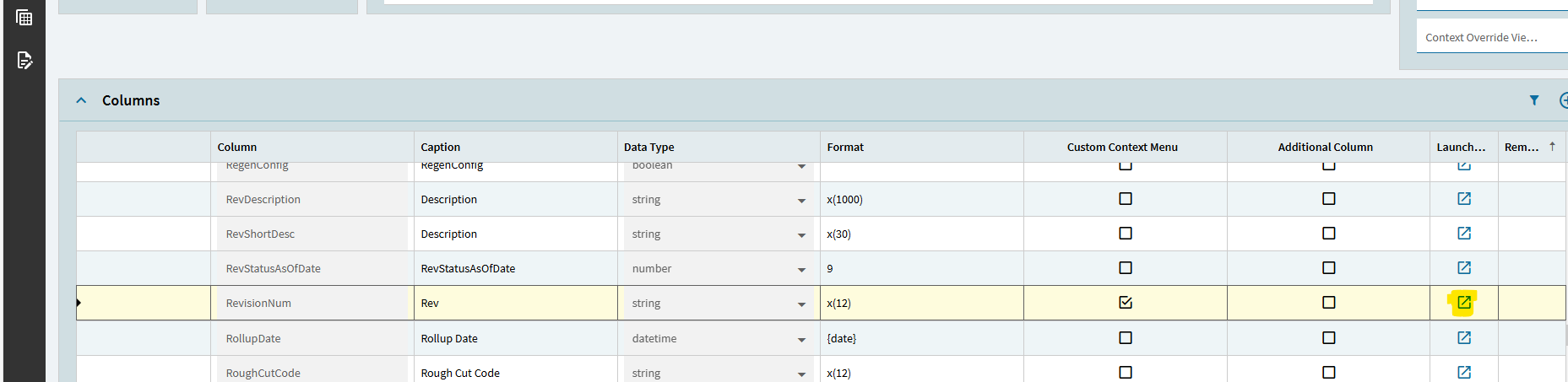

I customised it within the part entry screen within application studio. I went to Data Views - PartRev. Then searched for RevisionNum
Then opened launch context menu and checked the ‘hidden’ tick box
