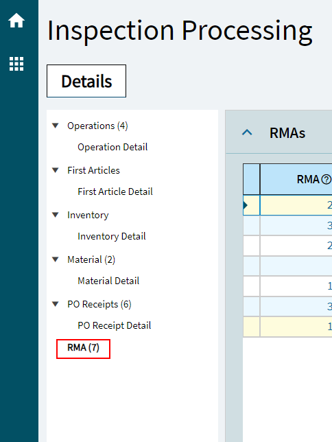

I am trying to customize a panel card that slides out of a screen. Within Inspection Processing, click RMA
When you select RMA, it displays a modified RMA panel card grid and when you click the hyperlink of an RMA number, a panel card slides out and shows the RMA information. I have already created and applied the customization to the menu item for RMA Dispositions (OMGO3016) and it works just as expected if I launch it from the menu. The issue is the panel card that slides out of Inspection Processing for the specific RMA does not load the customization. I have looked at the Console tab and inspected what happens when I click the RMA hyperlink on the Inspection Processing screen and it seems to be a huge list of API calls.

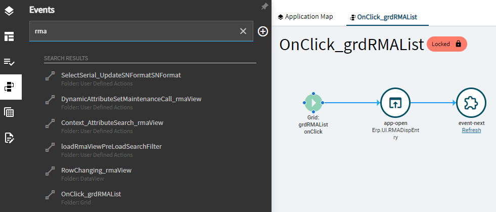

In Inspection Processing (Application Studio)… there is an onClick event that is triggered when you click the RMA link.
It is a base event… so you need to copy it. Right-click on it in the search and copy.

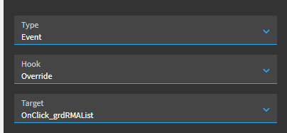

Change the Trigger to:

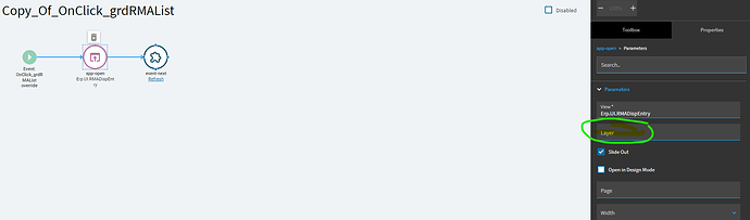

Now, in you new copy, click on the app-open widget… Properties > Parameters. You’ll see a spot there to add the name of your customized layer of that RMA slide out.
So, like you said, from the MENU, you already told it to open up that form with your custom layer in place.
But from the base event from Inspection Processing, the “App-Open” widget it telling it to open the slide-out (form) without the layer. So you have to recreate the event and tell it to apply that layer.

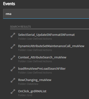

yeah, I hear you. A couple things (but yeah, mostly blind luck)… I searched for “RMA” because that’s what you’re clicking on… and saw an on-click event. I opened that and saw in the event it was an app-open to RMADispEntry… so, makes sense this is the one you want.

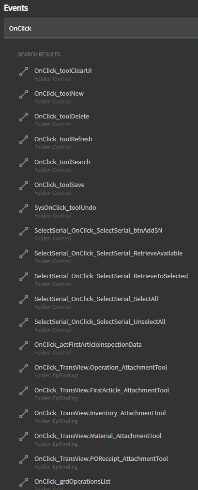

My other search, again, knowing the event (app-open) happened when you clicked a link would be to search with “OnClick”… Epicor’s event nomeclature (for the most part) is pretty consistent. The problem is on any given form, there is a LOT of OnClick events:
… like, (4) snips worth so I won’t paste them all here.
