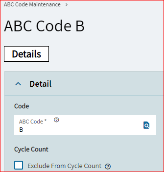

Not to necropost, but I wasn’t sure if anyone else had found a workaround. If you check off the field “ABCCode.ExcludeFromCC”, it will exclude parts when performing part selection under Cycle Count Schedule Maintenance. I had a similar case where we needed separate cycles based on product groups. We decided to assign different ABC codes to groups of products and create different cycles, as they would be performed by different personnel. When I wanted to schedule for code B, I unchecked this field for A, performed part selection and checked it back.
It worked for me, so I figured it might help others in the future!
