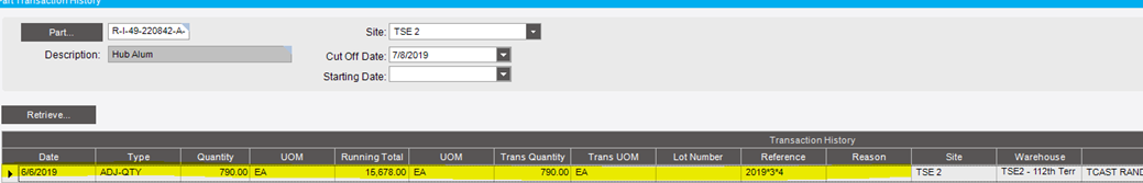

When a quantity adjustment is made, our configuration requires the user the select a reason code. But when the cycle count process makes adjustments, it leaves the reason code blank. Is there a way for the cycle count process to add a reason code?

If you do not select reason code in “Count Discrepancy Reason Entry” . It will show blank. You need to select a reason code in Count Discrepancy Reason Entry form.
