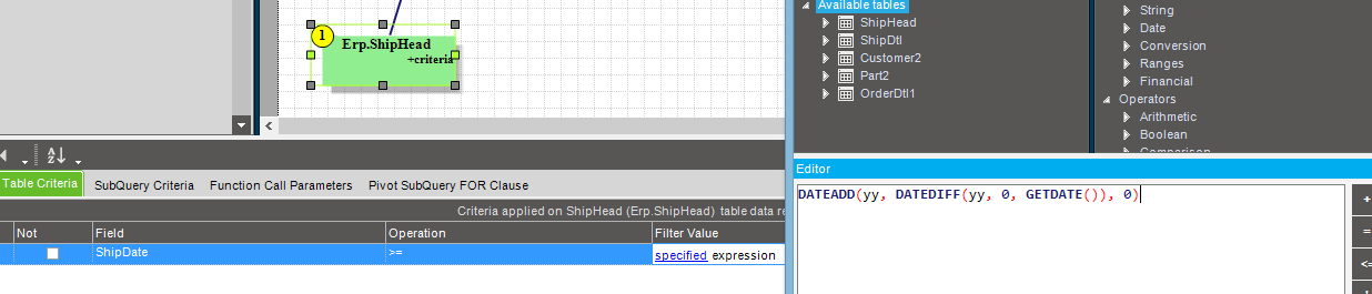

You can use table criteria to look at the current year, previous year, next year or whichever you would like.
First day of current year
DATEADD(yy, DATEDIFF(yy, 0, GETDATE()), 0)
Last day of current year
DATEADD (dd, -1, DATEADD(yy, DATEDIFF(yy, 0, GETDATE()) +1, 0))
First day of previous year
DATEADD(yy, DATEDIFF(yy, 0, GETDATE()) -1, 0)
Last day of previous year
DATEADD (dd, -1, DATEADD(yy, DATEDIFF(yy, 0, GETDATE()) +0, 0))
First day of next year
Last day of next year
DATEADD (dd, -1, DATEADD(yy, DATEDIFF(yy, 0, GETDATE()) +2, 0))
