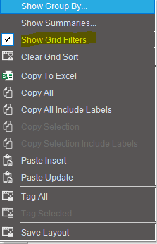

Can you send a screenshot of what options you are getting?
Should look like this.
I have an updateable dashboard with grid filters applied before it was deployed but it still lets you remove them if you right click and unselect it.
Yes, same as that… do you know if its possible to show/unshow grid filters via a hotkey or button ?
Hi @emzi1981, if it looks the same then you just select “Show Grid Filters” that will toggle it on and off.

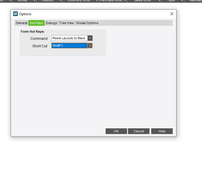

I don’t see an option specific to show/un-show grid filter but you can use “Reset Layout to Base” and that will work, note it will remove all other personalizations and I imagine, the dashboard needs to have grid filters removed before it was deployed too.
