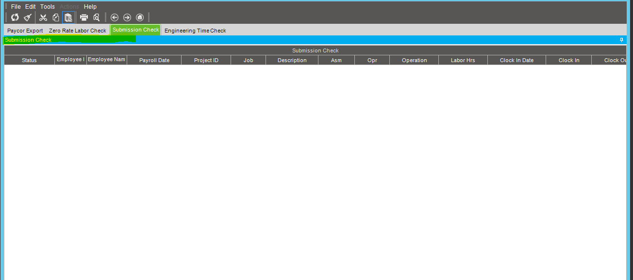

Putting together a dashboard…
Why does one tab have this blue caption bar…
…but the tab next to it doesn’t?

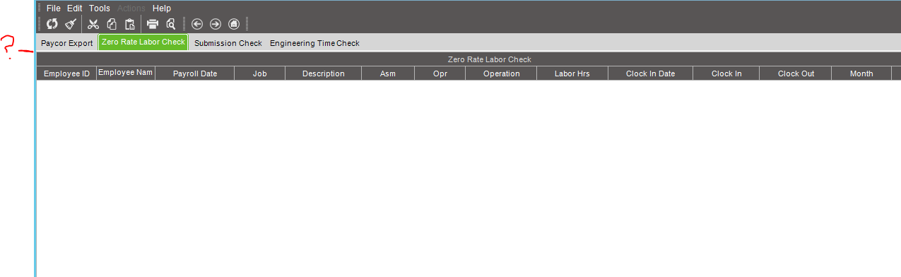

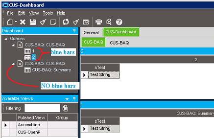

Can you show us the treeview? Usually get the blue bar when you have multiple gridviews for a query. And no blue bar when you have separate query/gridviews.
The two tabs I showed first are in fact the same BAQ with different filter criteria:

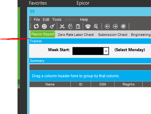

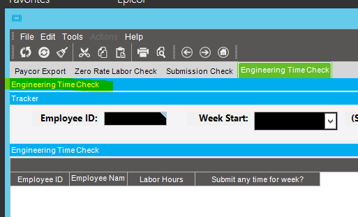

However, the other two tabs (Paycor Export and Engineering Time Check) are two other different queries, yet…
…the Engineering Time Check tab has the extra blue bar…
…while the Paycor tab does not:

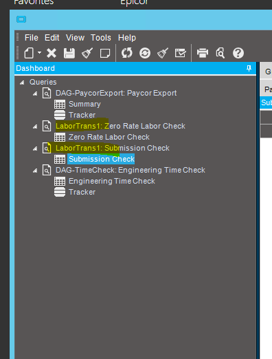

Yeah, it can be a fishing expedition trying to track down dashboards quirky inconsistencies like this.
Off the top of my head, the difference you described will end up being related to the order in which the query grid/tracker views were added.
(in addition to differences due to single vs multiple gridviews previously mentioned).
As an experiment, I’d be curious to know what happens to blue bars
if you can temporarily remove the tracker view from either “DAG-TimeCheck”, or/and “DAG-PaycorExport”.
