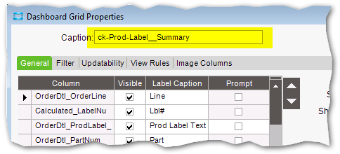

The caption of a dashboard grid is used as the data source name for linked reports.
I had a Dashboard with linked reports, that needed some minor tweaking. While I was at it, I figured I’d clean up the appearance. Particularly the names of some the panes and grids.
When the dashboard was originally made, the main grid view was captioned as shown below.
Wanting it to look nicer I changed the caption to “Labels to print”. But then the print links no longer worked right. The print previews showed the same data regardless of which records I selected in the dashboard.
Looking into the Crystal Report yielded the dataset name was “ck-Prod-Label__Summary”. Changing the caption of the grid view back, fixed the reports.
