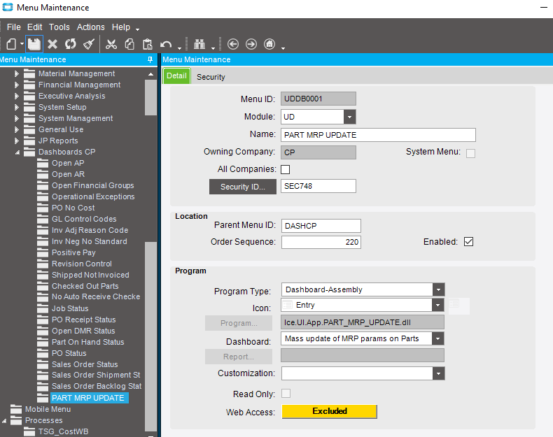

I think I might have found an issue??? I can find the dashboard on the security/menu maintenance. How do I get it, for example, in the Inventory Management section? Or even Exec Analysis/Status Dashboards?
How I do this since I am lazy it to check the add favorite Item which make the menu entry in the process section of the menu and is only shown in your dashboard assemblies favorites.
Then open menu maintenance and change the parent menu and order sequence to where you want it to show.

Just click the parent menu item, then NEW MENU with the create button. The biggest things to set are:
MENU ID (unique)
Name (As displayed)
Order Seq (relative to other menu items)
Program Type to dashboard (most likely assembly)
Dashboard: Select from dropdown
Customization (if needed)
Also don’t forget to set security on other tab if needed

I’m still having an issue, though and can’t figure out why. I have successfully added the dashboard to the menu - it is marked as dashboard-assembly. Security set for me. Copy to Excel option is there. However, when I click it - nothing happens. Excel doesn’t open. No error message. Just nada. I have closed and re-opened Epicor several times.
